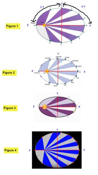

Hi again,
I'm facing a problem which I'm trying to understand more qualitatively than quantitatively.
Please have a look on the attachment, or for hi-resolution have a look here: https://imageshack.com/a/img924/6138/hNTkVC.jpg
Equal areas are swept in equal times as Kepler's 2nd law says. In Figure 1 from the attachment, is there a fixed proportion between the time elapsed from X→Y and from Y→Z, i.e. XY/YZ=constant?
From looking at the figures, the relation I could see is around XY/YZ=4/2.
I understand that my question is too general and lacks any quantitative treatment so if you could possibly comment on it, I'd really appreciate. Thank you.

No. Consider the case as the eccentricity of the ellipse approaches zero (the ellipse becoming a circle). By symmetry the two times must then be equal. Clearly then the ratio cannot be the same for all (closed) orbits.

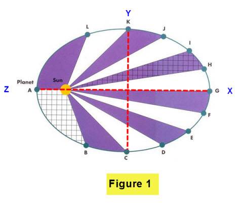

Let me put it differently. Please have a look on the attachment. My confusion is arising from the understanding that time taken by a counterclockwise orbiting planet from G to H is T, from H to I is also T, and so on. In other words, the letters along the curve divide the curve into equal time segments. This way all the elliptical orbits with same eccentricity but with different lengths for major axis will have same number of 'T' time segments along the curve. I'm not sure if I'm correct.
To me, your reply suggests that as the eccentricity changes, the number of 'T' segments will change but my possibly flawed understanding assumes that the number of 'T' segments only remain the same as long as eccentricity is the same for the given orbit. Please guide me where I have it wrong. Thanks a lot.

That's fine, but keep in mind that the area of the ellipse can be carved into an arbitrary number of equal-area segments. So saying that different ellipses have the same number of 'T time segments' is not useful.
If, for a different ellipse with the same eccentricity you divide the area up into the same number of segments in the same way, then clearly the number of segments will be the same. However, for differently sized ellipses the actual value of T will be different.
Again, the number of segments shown is arbitrary, chosen by the illustrator to best convey the principle. You can divide any ellipse in the same way, so in that sense the number of segments is the same for all ellipses. But for any two ellipses, even those with the same eccentricity, the actual time associated with the segments will be different.
