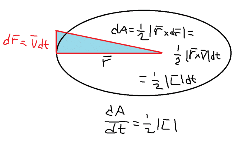

I usually explain it like this (dr vector is exaggerated for the sake of the picture)
Where I used that the area of the entire parallellogram formed by the r and dr vectors is equal to the magnitude of their cross product. Here we have half a parallellogram, hence the facor 1/2
Here it is with LaTex:
##\mathrm{d}\vec r = \vec v \mathrm{d}t##
## \mathrm{d} A = \frac{1}{2}| \vec r \times \mathrm{d}\vec r| = \frac{1}{2}| \vec r \times \vec v|\mathrm{d}t =\frac{1}{2}| \vec L |\mathrm{d}t ##
If L is conserved then ## \dfrac{\mathrm{d}A}{\mathrm{d}t}## is constant and thus by integrating it we get the area swept out during a certain time interval is constant along the path

I guess you mean ( mass is missing)
## \mathrm{d} A = \frac{1}{2}| \vec r \times \mathrm{d}\vec r| = \frac{1}{2}| \vec r \times \vec v|\mathrm{d}t =\frac{1}{2m}| \vec L |\mathrm{d}t ##
Nice way of explaining it. Just what I was looking for. Thank you.

Yes I forgot mass.
