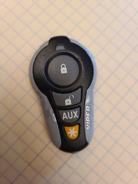

Yesterday the batteries died on my key fob and I didn't have the appropriate batteries to replace them. I thought I could use my power supply to operate the key fob to open the car door but it did not work. I thought that it may be caused by a noisy power supply at the higher frequency range of 432MHz but when I got my hackRF to investigate the waveform with the battery and then with the power supply, I was shocked to find no signal at all. I have since replaced the batter and everything works great, but as a recently graduated EE I am at odds with what is going on. Can anyone help me figure out this mystery. Here is a youtube link of the issue

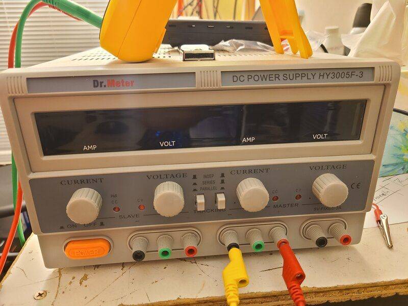

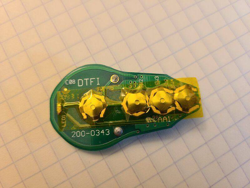

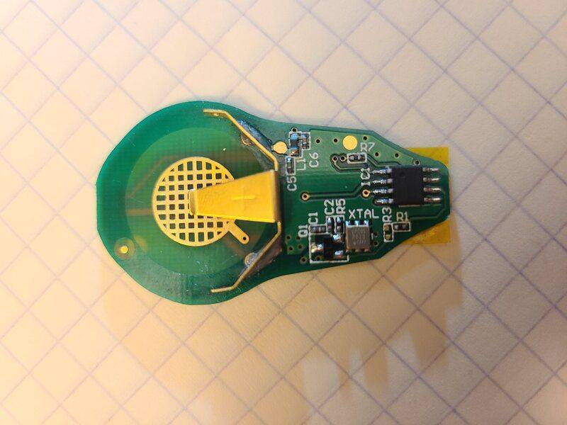

Is the current limit on the power supply set high enough (do you maintain full 6V at transmit?). Are the multiple pads (square array) on the negative battery pad there for a functional reason? Must admit I'm flummoxed...grasping at straws
Likes thatsmessedup
I cranked up the current limiter and also tried a different variable power supply with no luck. I can't imagine that the grid is anything more then to make sure the battery is touching.
This is the power supply I'm using.

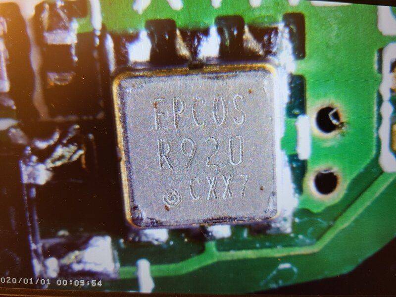

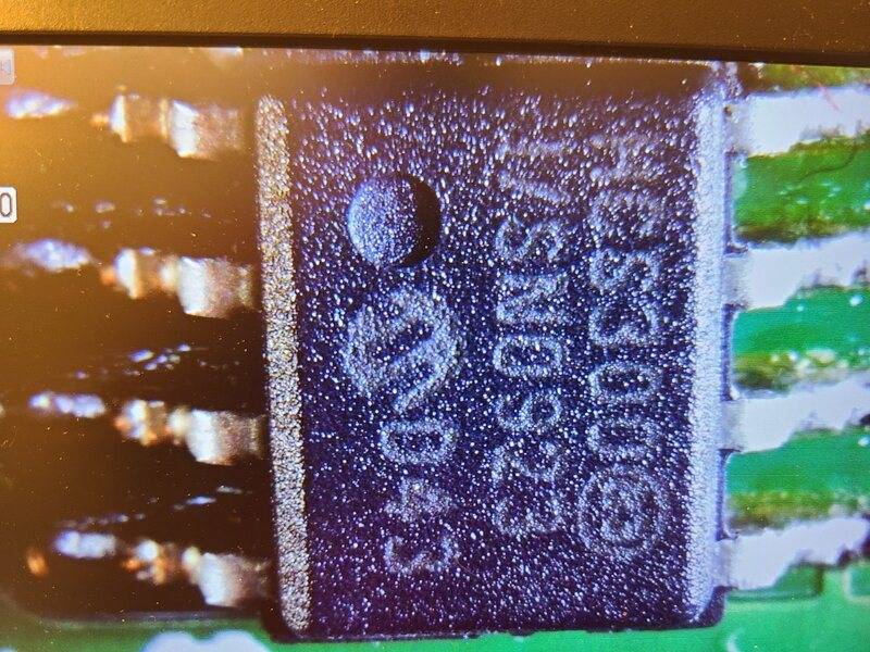

Here are some closeups of the two major chips on the PCB.

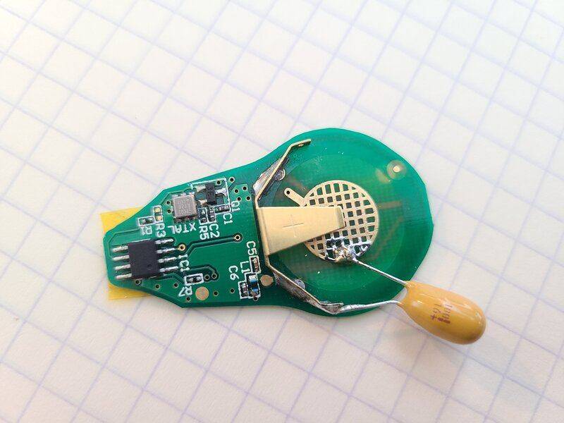

Is the battery used as the antenna somehow? (I see no real antenna.)
Likes Keith_McClary
The thing has no sufficient buffer caps. Through a battery this is not a problem, it can support some silly big current peaks on short term: but a PSU wiring will prevent going through any HF current, so no power for transmit.
Add some 100uF tantal (or: ceramic - a miracle that you can have these in ceramic!) to the battery terminals when it's with a PSU. I think it'll work with that.

Your video shows it working with the battery and you holding it with one hand.
With the power supply, you are holding it with two hands, left hand to push the button and the right hand holding the clip lead on the battery contact. The index finger of your right hand is contacting the antenna loop around the edge of the pc board, thereby greatly loading and detuning the antenna; probably enough to to disable the xmit oscillator.
A method for power connection is to insert a piece of paper and a piece of Aluminium foil between the circuit board and the battery, foil against the board, paper to insulate the battery. You can then clip the power supply lead to the foil without frying the battery, while still powering the board.

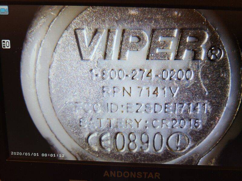

The last picture in this post shows a CR2016 which is a 3V battery.
[Edit:]But the video shows that there two of them so that is good (CR2032 equivalent).
(forestalling unfortunate incidents)
The CR2032 is a 3V lithium single cell just twice as fat . Two CR2016 in series are not equivalent so I am not sure what you are saying

Gave it a try with a 100[uF] tantalum capacitor on the terminals. Not a single blip from the HackRF.
This is a pretty simple looking device as far as individual components go. Have you made a schematic and taken some voltmeter readings? Are you sure you are actually getting the unit powered?
No I have not made a schematic, but I really thought the cap would make the fob do the magic. There are still many things that can be going on here. Possibly taking out the battery removed quite a bit of metal from inside the loop that is supporting the antennas resonance. At this point it would be hard to test as I need this keyfob to use my car and I'm a little scared ill do something stupid and damage the unit.
