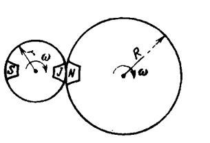

Three schoolboys, Sam, John, and Nick, are on merry-go-round. Sam and John occupy diametrically opposite points on a merry-go-round of radius R. The position of the boys at the initial instant are shown in fig
Considering that the merry-go-round touch each other and rotate in the same direction at the same angular velocity ω determine the nature of motion of Nick from John's point of view.
I have understood the argument given in the solution provided by the textbook which is
Let the merry-go-round turn through a certain angle φ Fig. We construct a point O(OA=R) such that points O,S,A and J lie on the same straight line. Then it is clear that ON=R+r at any instant of time. Besides, Point Ois at rest relative to John (Sam is always opposite to John). Therefore, from John's point of view, NIck translates in a circle of radius R+r with the centre at point O which moves relative to the ground in a circle of radius R with the centre at pointA.

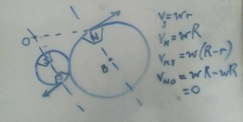

But, I can't seem to convince myself that Nick moves in a circle. I tried to reason using relative velocity follows:
$$v = \omega r$$
$$v_{AB} = v_A - v_B$$
(Please refer the image below. ) The velocity of Nick ##v_N=\omega r## and the velocity of John ##v_S=\omega R## is depicted. The relative velocity of Nick with respect to John will be ##v_{NJ} = \omega (R-r)##. The velocity is along the tangent to the circle centred at B. If Nick were to move in a circle centred at O from Sam's point of view, i would expect his relative velocity to be perpendicular to ON (which it is not).
Similarly, the velocity at instant of time of Nick with respect to point O is 0.
Both of these confuse me a lot. I would really appreciate any help. Thank You!

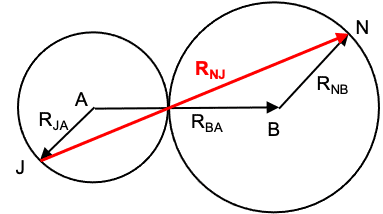

Drawing a diagram helps. Starting at J, you can get to N directly along the red vector or indirectly via the sum of the black vectors. That sets up the equation for ##\vec R_{\text{NJ}}.##

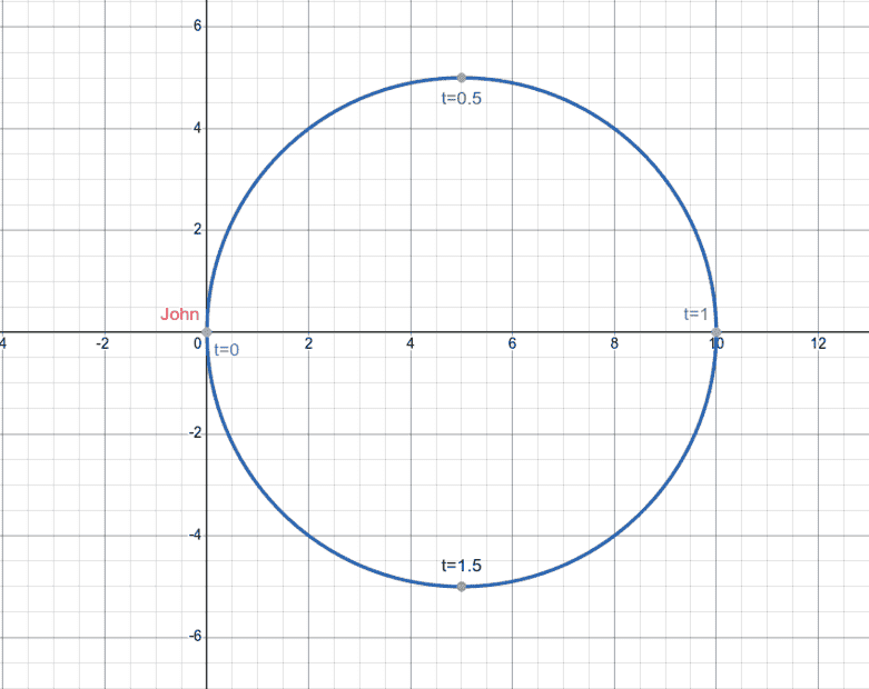

Well, The centre of the circle is ##(R+r)## term away from me due to the ##(R+r) \hat x ## term.
I also tried plotting it (by taking ##\omega = \pi## and ##(R+r)=5##:
But this centre isn't O. What am I missing out ?
Wait a min, It is O, isnt it. I gotta draw more diagrams.

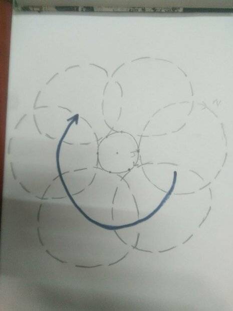

I tried to represent how I see Nick while depicting myself in ground frame. The solid line is how I move and the dotted line is how I see Nick at every instant.
Hmm, there's just one thing missing - the centre of nick's motion should be R away from me (not R+r, as in the diagrams), why is it so?
Could you please help me find it?
You have answered the question posed in the problem. The circle that you show in post #14 is Nick's position relative to John at different times. John stands on the circumference of a circle of radius ##(R+r)## and sees Nick move on the circumference of this circle. I think this is what the statement of the problem meant with "determine the nature of motion of Nick from John's point of view."
As for point O, imagine Oscar standing at point O and moving with it. What is John's motion from Oscar's point of view? Hint: Find an expression for ##\vec R_{\text{JO}}## and see what it says to you.

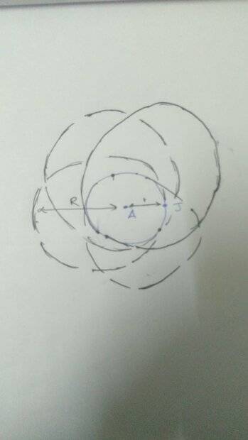

So I redrew my diagram, to account for these equations
Could you please check if this is right?
This looks good for the motion of Nick in the primed frame. John and point O are fixed in place in this frame. N moves counterclockwise on a circular path of radius R+r as shown in your diagram. O is the center of the path.
Shreya said:
I'm not sure what this picture represents.

The circle plotted in post #14 can be thought of as representing the motion of N relative to J if J always faces in one direction relative to the earth frame. So, if J is facing toward the left at the initial position, then J remains facing toward the left relative to the earth as time goes on. If we thought of John as a rigid body, we would say that John is in pure translation relative to the earth as he rides the merry-go-round. He does not rotate relative to the earth as he did when he was always facing Sam. In this scenario, John would now consider Sam to be orbiting around John.
John would now say that N moves along a fixed circle of radius R+r that lies behind him rather than in front of him. This is the circle plotted in post #14. John is at the origin and always facing left along the negative x-axis. John would say that point O also moves in a circle of radius R+r with the center of the circle located at John's position. So, O's orbit is identical to N's orbit except O's orbit is shifted a distance R+r in the negative x direction. John would say that point O is located, at each instant, at a distance R+r in the negative x direction relative to N. So, point O is not at the center of the circle of post #14 except at the instant when N is directly to the rear of John at maximum distance from John.
But I don't think this scenario is what was intended in the problem. I think we are to assume that John is always facing in a fixed direction relative to disk A, say towards Sam. So, John's frame of reference is a frame that is rotating relative to the earth. So, we transform to the rotating frame to get John's viewpoint.
That awfully drawn diagram was meant to represent how Nick's motion was perceived by John at different instants of time. I wanted to just confirm that the circle made by O was at a distance of ##R## from A (as was mentioned in the textbook explanation).
