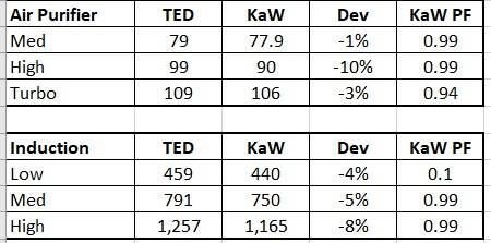

Mine works pretty well (readings in watts):
...and this was with the TED whole house readings not being completely stable.
Vs an older version of this: https://www.theenergydetective.com/content/the-energy-monitoring-system-you-have-been-waiting-for
