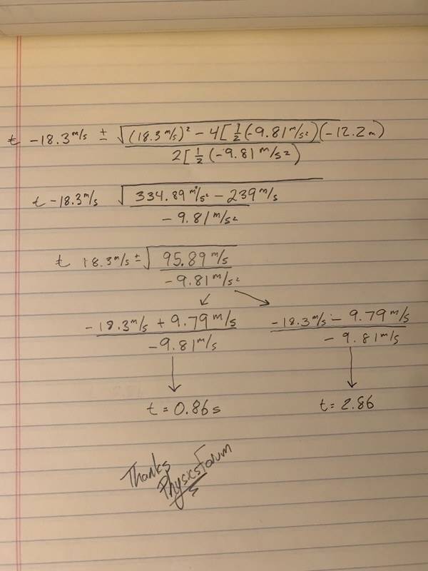

In summary, the student threw her pencil upward at 18.3 m/s and it took it 2.86 seconds to first reach a point 12.2 m higher than where it was thrown. The student then incorrectly retained the square root sign and got two positive results from -18.3±29.36.
Delta_Craig
I just ran this pretty quick at work. But this is the general outline. Sorry for the slop, it will get better with time. Thanks in advance and any additional info can be supplied.

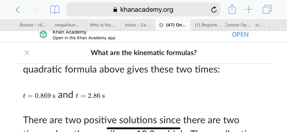

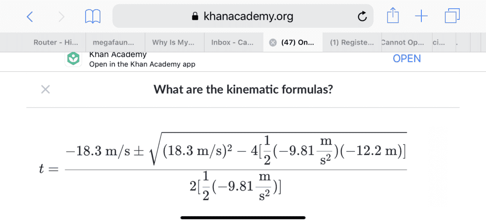

The material is from the Khan free course.
A student is fed up with doing her kinematic formula homework, so she throws her pencil straight upward at 18.3 m/s.
How long does it take the pencil to first reach a point 12.2 m higher than where it was thrown?
Answers are suppose to be
t1= 0.869s
t2= 2.86s
My answers are negative time which is a neat concept. Doesn’t add up.

It would be interesting to see your quadratic equation for ##t##.
Your first error is in line 2, where you have applied the same factor 1/2 to both g and s.
The next error is in multiplying those out you got a number near 1200 instead of near 120.
The result of that error was a negative number to square root, but instead of recognising something was wrong you just ignored the sign.
In your posted image, you then erroneously retained the square root sign having already substituted the root value.
Finally, you somehow got two positive results from -18.3±29.36.

It's so easy to go wrong with numbers I always find. ##g## is one symbol; whereas ##9.81m/s^2## is eight symbols.
Why would anyone prefer eight symbols when one would do?

Do they really teach you to do it that way? It seems extraordinary to me. I would never think of doing like that.
I just did, with up postive:
##s = v_0t - \frac 1 2 gt^2##
##\frac 1 2 gt^2 -v_0t + s = 0##
##t = \frac{v_0 \pm \sqrt{v_0^2 - 2gs}}{g}##
And I just plugged the numbers in a spreadsheet and out came the answer you quoted.

sat down and figured out the issue pretty quick.
On line 2, under the square root you are subtracting a velocity (m/s) from a squared velocity (m2/s2).
On line 3, the squared velocity is no longer squared. But you are about to take the square root of it.
On line 4, the square root of an un-squared velocity turns into an un-squared velocity.
If you are going to track units, track units.
