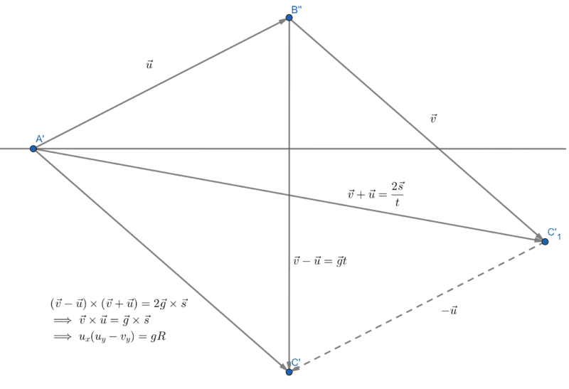

With reference to the above vector diagram and derived equation, let ##h_1## be the maximum height of the projectile above launch point and ##h_2## be the maximum height of the projectile above impact point. Then:
$$u_y=\sqrt{2gh_1} ,\;\;\; v_y=-\sqrt{2gh_2}$$and $$ u_x=\frac{Ag}{\sqrt{2gh_1}}$$
Hence: $$gR=\frac{Ag}{\sqrt{2gh_1}}\left(\sqrt{2gh_1}+\sqrt{2gh_2}\right) $$
$$\implies R = A\left(1+\sqrt{\frac{h_2}{h_1}}\right)$$
The above vector diagram is sourced from this article.
