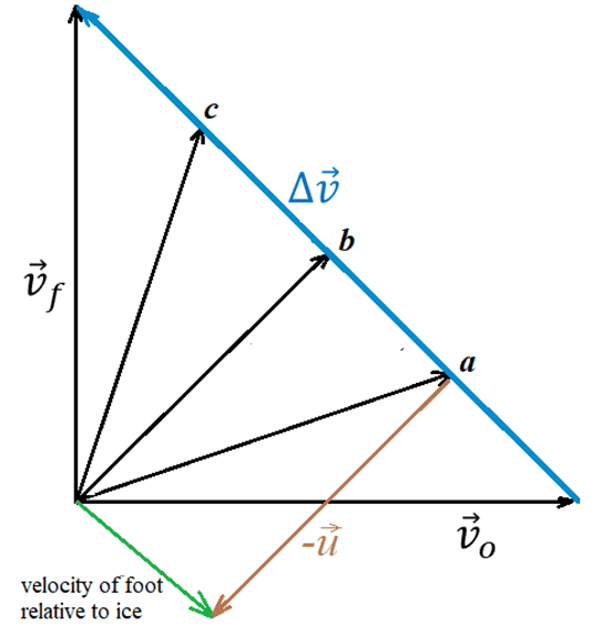

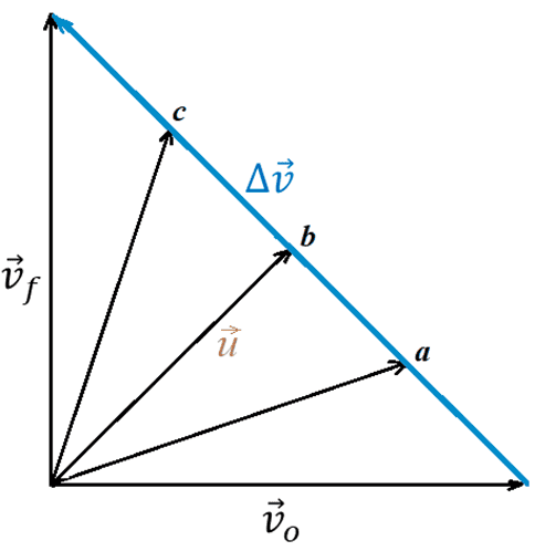

Following on from my post #5, it is interesting to consider what the boy has to do.
Let his velocity be ##\vec v(t)##, the net velocity change required be ##\vec{\Delta v}##, and his acceleration be ##\vec a=\frac{\vec{\Delta v}}{|\vec{\Delta v}|}\mu g##.
If he "runs" with velocity ##\vec u##, by which I mean he slides the soles of his shoes on the ice at velocity ##-\vec u## relative to his body, then they slide at ##\vec v-\vec u## relative to the ice.
Since the magnitude of the acceleration does not depend on ##\vec u##, any component of that parallel to ##\vec{\Delta v}## is wasted effort. It follows that for least effort ##\vec u=\vec v-\frac{\vec v\cdot\vec{\Delta v}}{\vec{\Delta v}^2} \vec{\Delta v}## where ##\vec v=\vec v_0+\vec a t##.
Note that this is the component of ##\vec v## normal to ##\vec{\Delta v}##, which is unchanged by the acceleration. Hence
##\vec u=\vec v_0-\frac{\vec v_0\cdot\vec{\Delta v}}{\vec{\Delta v}^2} \vec{\Delta v}##.
Unsurprisingly, this breaks down in the special case of the initial and final velocities being parallel.

This is interesting.
Consider the case where the velocity changes 90 degrees, starting East and ending North.
The diagram shows the initial and final velocities, as well as intermediate velocities at ##a, b##, and ##c##. The velocity at ##b## is perpendicular to the overall change in velocity ##\Delta \vec v##. I believe this velocity corresponds to your running velocity ##\vec u##.
The velocity that the foot slides relative to the ice is ##\vec v(t) - \vec u##. Thus, for the instant of time corresponding to ##a##, we have
The green arrow shows the velocity of the foot relative to the ice. This has the correct direction to cause the friction force on the body to be in the direction of ##\Delta \vec v##.

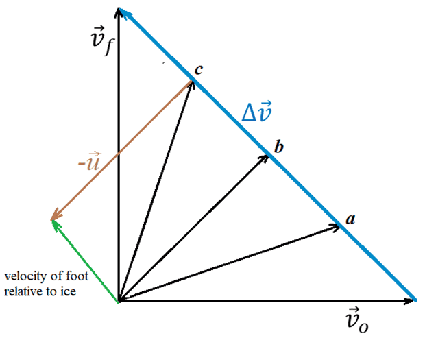

But if we consider the time corresponding to ##c##, we have
Now the foot is sliding in the wrong direction. Thus, the person would need to add a component of running velocity in the direction of ##\Delta \vec v## with a magnitude at least equal to that of the green vector.
Is this right?

Well spotted. The flaw in my analysis is here:
But the direction does depend on ##\vec u##, and the boy has to ensure that is the right way along the line of ##\vec{\Delta v}##.
In fact, the problem starts at b, where, according to post #13, there would be no acceleration. The boy has to supply a minimal movement of the feet to maintain thrust.
From that point on, the velocity of the foot on the ice needs to be ##-\epsilon\frac{\vec{\Delta v}}{|\vec{\Delta v}|}## for some ##\epsilon>0##, so ##\vec u=\vec v+ \epsilon\frac{\vec{\Delta v}}{|\vec{\Delta v}|}##.
I think this also fixes the special case I mentioned.

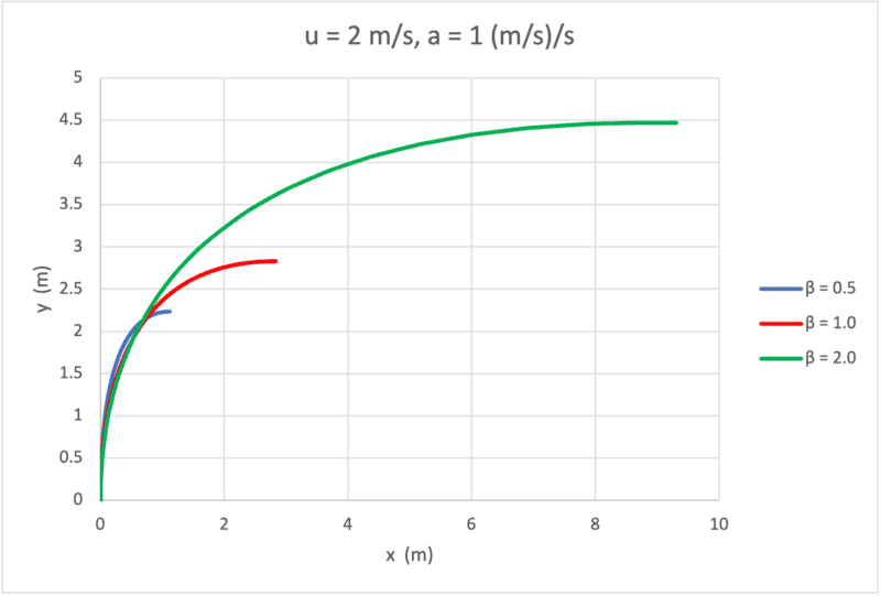

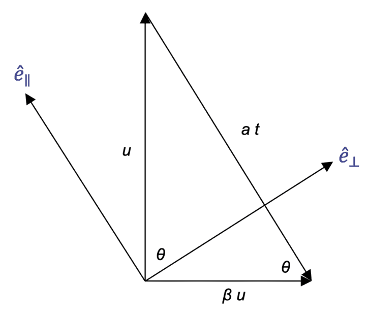

I became interested in plotting the trajectory of the skater so this is what I did.
We have seen elsewhere(1) that when a body is displaced by ##\mathbf s## under constant acceleration ##\mathbf a## the expression $$\mathbf a\times \mathbf s=\mathbf v\times \mathbf u$$ relates the cross product of the two quantities to the cross product of the final velocity ##\mathbf v## and initial velocity ##\mathbf u.## We write the displacement as the sum of two vectors, perpendicular and parallel to the acceleration, ##\mathbf s=\mathbf s_{\perp}+\mathbf s_{\parallel}##(2). Then $$\mathbf a\times \mathbf s=\mathbf a\times \mathbf (\mathbf s_{\perp}+\mathbf s_{\parallel})=\mathbf a\times \mathbf s_{\perp}\implies s_{\perp}=\frac{|\mathbf v \times \mathbf u|}{a}.$$ Quantity ##s_{\perp}## is optimized (maximum) when the initial and final velocities are perpendicular. We write final speed as a fraction/multiple of the initial speed, ##v=\beta u## and find $$\begin{align}s_{\perp}^{\text{max}}=\frac{vu}{a}=\frac{\beta u^2}{a}.\end{align}$$
We will now find an expression for the trajectory of an object the changes direction from due North to due East with initial speed ##v_0=u## and final speed ##v_f=\beta u## under constant acceleration ##a.## The velocity diagram on the right will guide our thinking.
We identify ##\mathbf{\hat e}_{\perp}\rightarrow\mathbf {\hat x}##, ##\mathbf{\hat e}_{\parallel}\rightarrow\mathbf {\hat y}## and find the trajectory when the initial speed is ##u## and the projection angle is given by ##\tan\theta=\frac{u}{\beta u}=\frac{1}{\beta}.##
In order to sketch the trajectories, the idea first to generate standard projectile plot points ##(x,y)## in which the acceleration is along the vertical and then rotate the entire plot counterclockwise by ##\varphi=\frac{\pi}{2}-\theta## to put the initial velocity vector, which is at angle ##\theta## above the horizontal, in the vertical direction. Then plot rotated coordinate points ##(x', y')## according to $$
\begin{pmatrix} x' \\ y' \end{pmatrix} =\begin{pmatrix}
\cos\varphi & -\sin\varphi \\
\sin\varphi & \cos\varphi \\
\end{pmatrix}\begin{pmatrix} x \\ y \end{pmatrix}.
$$The graph below shows three trajectory plots at exit speeds that are, (a) half (##\beta=0.5##), (b) equal to (##\beta=1.0##), and (c) twice (##\beta=2.0##) the entry speed ##u##. Each plot was terminated at the value of ##s_{\perp}^{\text{max}}## provided by equation (1).
(1) https://www.physicsforums.com/insights/how-to-solve-projectile-motion-problems-in-one-or-two-lines/
(2) In projectile motion ##s_{\perp}## is identified as the horizontal displacement ##\Delta x## and ##s_{\parallel}## as the vertical displacement ##\Delta y##.

This seems a bit convoluted when the general solution is quite obviously ##\vec x(t) = \vec v t + \frac{\vec u - \vec v}{T} \frac{t^2}{2}## regardless of initial and final speed. Just insert values for ##t##.
