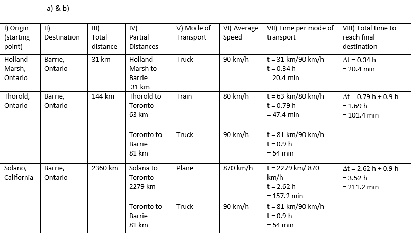

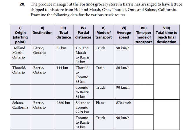

a) Calculate the time per mode of transport of the lettuce from each starting point.
b) calculate the total time required for each complete journey of the lettuce from its origin to Barrie
c)
d)
e)
time = distance / speed or t = d/v

a) and b)
- for a) to calculate time per mode of transport, i divided the partial distances by the average speed
- for b) to calculate the total time i added the time per mode of transport
please tell me if this is correct.
