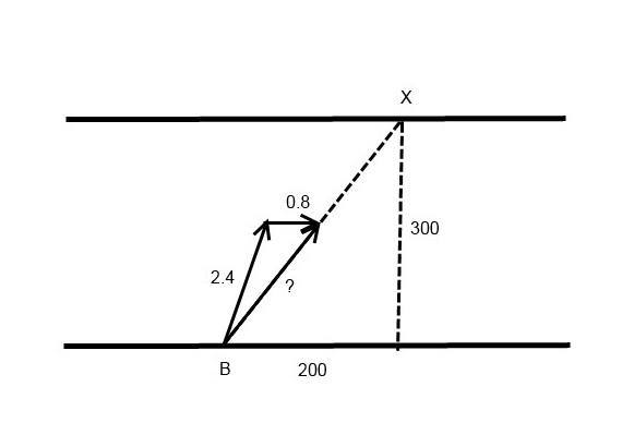

Start by drawing a diagram: draw two lines representing the banks of the river, the straight line from B to X, the line down the river from B to the point on the bank opposite to X, and the line from that point to X. The gives a right triangle. You can analyze that by taking the speed of the river for the line down the river and the speed of the canoe for the distance across the river.
This is a vector addition problem. You should have three velocity vectors on your diagram representing...
* The velocity of the river (direction west to east at 0.8m/s)
* The velocity of B (unknown direction at 2.4m/s)
* The resultant of these two (known direction B to X at unknown velocity)
Solve for the unknown velocity. Calculate the time taken.

so i had the right triangle already made and i found the total distance that he needs to travel is 360.5m. But I am having a little trouble analayzing the velocity triangle... the the horizontal vector is 0.8 m/s but is the 2.4 m/s the the diagonal vector or the one straight across? and would i do 2.4 m/s + 0.8 m/s since he is going downstream?
So i did what you said CWatters and i found the unknown velocity to be 2.26 m/s? I think that's right but not really sure... but now i just do t=360.5/2.26?
I think the unknown velocity must be faster than 2.4m/s. Here is my drawing...

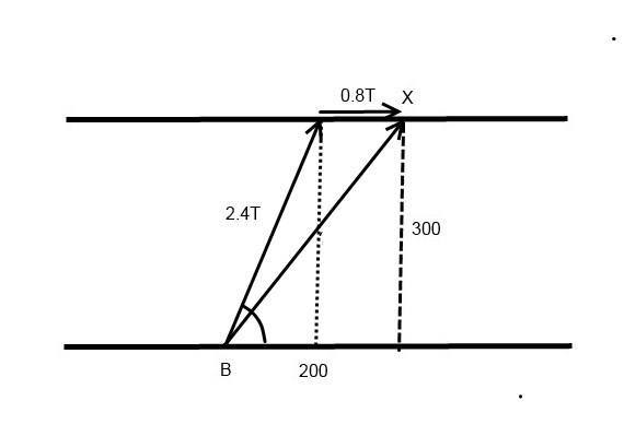

Actually this diagram might be easier to think about... T is the crossing time...

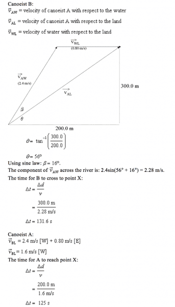

hey CWatters I apologize for such a late reply... i did not have access to the internet. I still need your help with this question if you have the time please. I found the answer to the question but I am having a hard time understanding how they got velocity of canoeist A to land diagram ... its the same exact diagram you showed me but I am having a really hard time figuring out how you drew that diagram with two unknown angles... the math is pretty easy for me I just don't unders
tand how the diagram was drawn... Also for the answer i found should it be referring to canoeist B in the first part and Canoeist A in the second? Any help would be greatly appreciated...
Perhaps this helps..
Canoe A
The calculation for Canoe A is easy and doesn't need a diagram. It moves at 2.4m/s relative to the water but the water is flowing the other way at 0.8m/s. So the velocity relative to the land is 2.4-0.8 = 1.6m/s. Time = distance/velocity = 200/1.6 = 125 seconds. Happy with that?
Canoe B
This needs a diagram. I'll refer to the one you found. This shows that the resulting velocity of the canoe VAL is the sum of two other vectors VAW and VWL.
Lets say the time it takes canoe B to make the crossing is T.
The problem statement says that the resultant distance VAL * T is the "most direct route"
VWL * T represents the effect of the current West to East. eg the distance canoe B would drift East in time T.
VAW * T represents the heading the canoe has to take in order to account for the current.
If you multiply all the sides of a triangle by the same quantity (eg T) then it just scales and the angles stay the same. In this case this allows you to show velocities and distance vectors on the same diagram and to work out the angles θ and β.
Their working shows how to caulate the time T that canoe B takes.
Then just subtract the two times.
ooh okay that makes so much more sense thanks for your help CWatters just one last question if you don't mind... we are given V_aw= 2.4 m/s right? so what does it mean when it says: "The component of https://www.physicsforums.com/file://localhost/Users/alikhan1/Library/Group%20Containers/UBF8T346G9.Office/msoclip1/01/clip_image002.gif across the river is: 2.4sin(56° + 16°) = 2.28 m/s."? I thought we were trying to find the resultant vector (V_al) ? Last question and hopefully ill stop bothering you lol
30294 said:
we are given V_aw= 2.4 m/s right? so what does it mean when it says: "The component of across the river is: 2.4sin(56° + 16°) = 2.28 m/s."? I thought we were trying to find the resultant vector (V_al) ?
There are actually three ways to solve this part of the problem. They selected a different method.
You will recognise the basic equation...
so the next step is to find some distances and velocities to use in that equation. There are three possibilities..
a) The resultant vector method..
Time = Distance from B to X / VAL
where
Distance B to X = Sqrt{2002 + 3002}
VAL = Sqrt{(2.4Cos(56.3°+16°)+0.8)2 + (2.4Sin(56.3°+16°))2}
so
Time = Sqrt{2002 + 3002} / Sqrt{(2.4Cos(56.3°+16°)+0.8)2 + (2.4Sin(56.3°+16°))2}
= 360.56 / 2.751
= 131 seconds
b) The component across the river (the method they used)...
Time = Distance across river / component of velocity across the river
= 300 / 2.4sin(56.3° + 16°)
= 300 / 2.28
= 131 seconds
or
c) The component down the river...
Time = Distance down river / component of velocity down river
= 200 / (2.4cos(56.3° + 16°) + 0.8)
= 200 / 1.53
= 131 seconds
