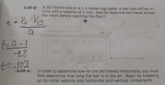

Sorry about all the erase marks. My question is why is the final velocity not 0.
V=Vo+at[/B]
So the question is asking for the horizontal distance the ball travels before it hits the floor. First to solve this I decided to solve for time. To do this is used V=Vo+ at which I rearranged to t=(V-Vo)/a. Using just the vertical component, I decided the vertical velocity of the ball when it reaches the floor is 0. So I did (0-1)/-9.8 which gave me a time of .102. The book solved for the final distance first and then solved for time
My question is why is the final velocity no just 0. When it reaches the floor it can't have a positive velocity because it has stopped moving.

You know the ball falls for a certain distance when it rolls off the table. There's a SUVAT equation which deals with distance traveled under uniform acceleration, given an initial velocity. Why didn't you use this equation to find the time of the fall?
No, that is after it has hit the floor. The equation you used is only valid for constant acceleration, so only until it is just about to touch the floor.
