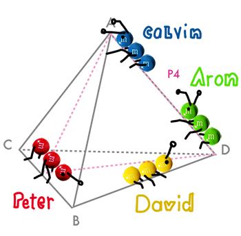

4 ants are arranged in such a way that they make up vertex of a regular tetrahedron, of side length 1m . The ants are named Calvin , Peter , David and Aron. Each ant moves at a speed 1m/s , and moves in such a way that:
Calvin moves toward Peter,
Peter moves toward David,
David moves toward Arron,
Arron moves toward Calvin
If they continue to moves it this direction they will converge somewhere. What time in seconds will it take the ants to meet each other?

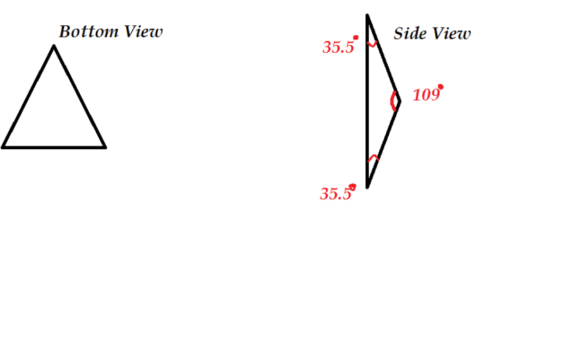

The base of tetrahedron will form an equilateral triangle.
Length of side of equilateral triangle(a)=2cos 35.5

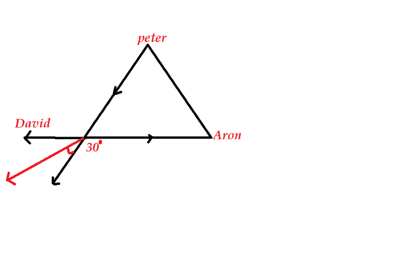

It is given Peter moves toward David, David moves toward Arron.
V[itex]_{PD}[/itex](relative velocity of Peter w.r.t.Arron) =√3V
Projection of V[itex]_{PD}[/itex] on line of motion of Peter=√3Vcos30[itex]^{°}[/itex]=[itex]\frac{3V}{2}[/itex]
now
[itex]^{0}_{a}[/itex]dl=[itex]^{t}_{0}[/itex][itex]\frac{3V}{2}[/itex]
t=2a/3V
=4*cos(35.5)/3
But this is not correct.

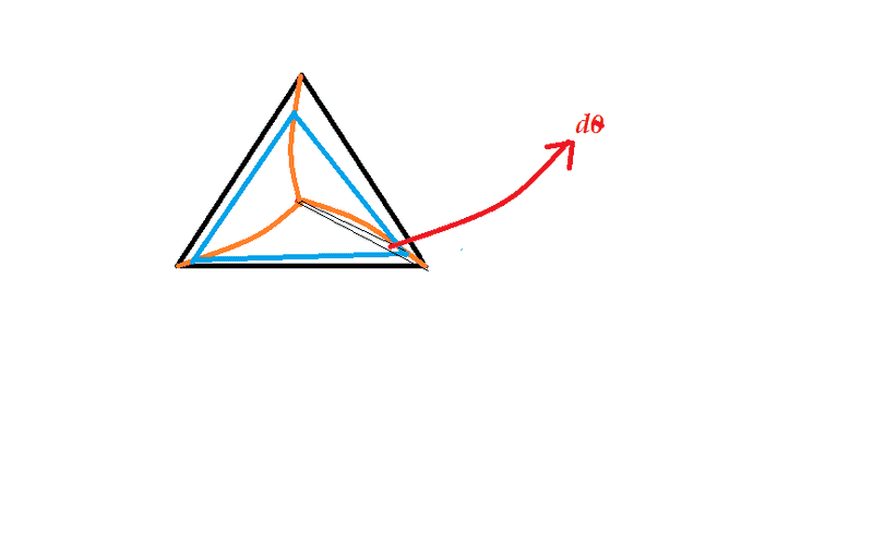

I think they will meet at O.
What do you mean? It is given that the sides of the tetrahedron are of 1 m length.
ehild
ehild
I thought 1 m length to be a bond length in tetrahedral structure as taken in chemistry.:-p
where as in this question it should be the edge length of the tetrahedron,
According to figure in post#3 it is AC,BD,BC,AB.
Are my further steps correct?
Your picture with the ants is magnificent!

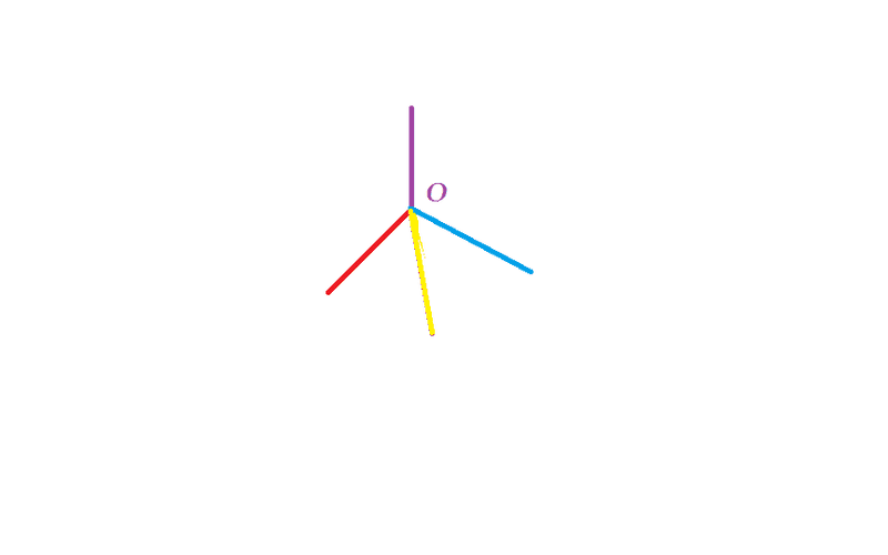

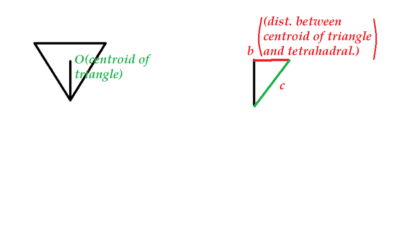

Is this displacement equal to distance between vertex and centroid of Tetrahedral?
I think that the centroid of the base triangle is just below the centroid of tetrahedral.
Let c be the distance between the vertex and centroid of tetrahedral.
So, by Pythagoras theorem
1/3+b^2=c^2
To find c I need to find another equation in terms of b and c.
Could you please help,ehild?
Yes.
√(3/8) a
ehild

You need to apply Pythagoras a few times. Determine the height h of the tetrahedron from the yellow triangle.
The blue triangle is isosceles. In the green triangle, one leg is h-r, the other is a/√3. r is the hypotenuse.
Check the spoiler in post#12.
ehild
ehild
Thank you ehild
I got it √(3/8).
t= √3/√8 *√3/√2=3/4=0.75
