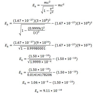

a) I am including the calculations I have done on my word document page to make it more legible than typing it in here. Please see the attached image.
I think my work is right, but I have cross-referenced this answer with others and the math does not seem to be right... it seems to be correct until at least the step where:
Ek = 1.50 * 10^-10 / sqroot(1.9999*10^-4) - 1.50 *10^-10
After that I am not sure, but the answer I keep getting is 9.11 * 10^-10, and other answers, deemed correct have a totally different number multiplied by 10^-8...
I have been reworking this and trying to figure out where/if my calculation is wrong and I'm stuck.
b) For this question, all I do is divide the two numbers for the ratio, correct? This question is worth three marks and it seems like they want something more than just this? Am I missing something?

In your penultimate step you have divided by 0.141... instead of 0.0141...

Oh! Is that my only mistake with calculations? Thank you so much.
