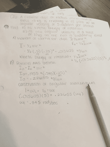

My problem Is slightly different, would you say this is correct? Sorry I am just very confused.
You should really open your own thread, but it certainly is the same as the original problem in this thread.
Your calculation of the new MoI is in respect of an axis at the perimeter of the disc. That would be fine if that point were the new centre of rotation, but it will not be. The mass of the attached object must feature in the answer. E.g. if the attached mass is very small there will be little change to the rotation of the disk.
