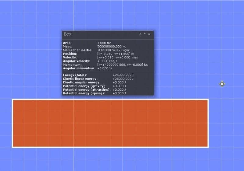

Imagine this object as a big tanker ship, moving to the right
weight 500 000 metric tones
linear velocity 0.01 m/s
momentum cca 5 000 000 kg m/s
kinetic energy 25 000 J, which is 25 kilowatt-secondshow much power could i extract from this object in order to slow it down to complete stop ?
Obvious answer is amount if kinetic energy, but seems to be negligible compared to its momentum.
According to this, 100% efficient motor or piston or any device consuming 25 kw during 1 second should stop the object in 1 second, which is in pretty unreal
So what am i missing here? How do i calculate extractable power correctly from such straight moving object?

yes i tried it, it takes force 5 000 000 Newton during 1 second to stop it, distance traveled 0.005 meter
W=Fxd
so work is 25000J , during 1 second that's Power 25kilowatt-seconds, so math is correct ,
just intuition cannot handle fact that you can stop half a billion kilograms of moving mass with 1 second burst of 25 kw
Yeah - you tend to think of a slow moving huge mass as unstoppable don't you?
Either 25kW is not as small as you thought or half-a-billion kgs going slowly is not as hard to stop as you thought.
Certainly 5 million Newtons sounds like a big number - but it acts over a very short distance ... so that's why the energy feels small.

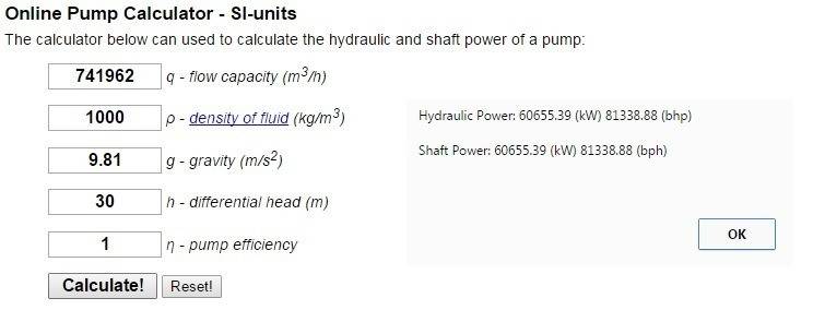

so let find better example , how to achieve 5 000 000 N in real life

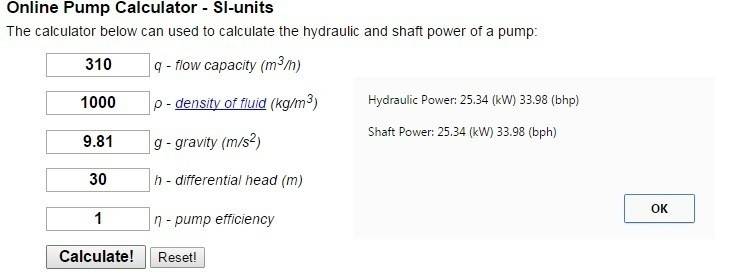

lets try to stop tanker with 100 efficient water pump and water jet so no energy is wasted on anything else
what force can we generate with 25 kw pump?
setup 1.
Force of jet on a plate = mass flow rate per second x water jet speed
= 86.11 kg/s x 24.26m/s = 2089 Newton...using 100% efficient system
in order to get 5 000 000 Newton , water pump would have to be bigger x2400, again tens of megawatts
so what am i missing here again ?
You are putting a lot of energy into the spray that is splashing off of the front of the tanker. Assuming no energy losses in the splash, the spray carries away slightly more than 100% of the power that you are supplying with the pump.

ok i understand now why intuition misguides in this case so much
25kJ it is30m water height that's some water pressure value which needs to be set , besides massflowrate, so i set to 30m, could be any number, but higher pressure and lower mass flow rate generates even less force for our purpose
The differential head is the maximum height the pump can push the water.
