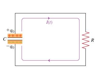

To understand the behavior of the current and voltage in a simple R-C circuit
A capacitor with capacitance C is initially charged with charge q0. At time t=0 a resistor with resistance R is connected across the capacitor
PART A
Use the Kirchhoff loop rule and Ohm's law to express the voltage across the capacitor V(t) in terms of the current I(t) flowing through the circuit
PART B
We would like to use the relation V(t) = I(t)R to find the voltage and current in the circuit as functions of time. To do so, we use the fact that current can be expressed in terms of the voltage. This will produce a differential equation relating the voltage V(t) to its derivative. Rewrite the right-hand side of this relation, replacing I(t) with an expression involving the time derivative of the voltage.
For PART A I got the answer to be V(t) = I(t)R, but I'm having problems with the PART B. I'm not sure what the "time derivative of the voltage" is. Any suggestions?
Remember that C=Q/V, and dQ/dt=I(t)
I need to stop here if the problem was to actually FIND the differential equation, because any more and I'd pretty much finish it >_> Take a stab keeping in mind what I typed
The only thing that comes to mind is:
[tex]V(t) = \frac{dQ}{dt}R[/tex]
but I don't think that's the right answer.
Ok more prodding
Q=C*V, take the derivative of both sides, dQ/dt=C*dV/dt (because C is constant)
oh look an expression for dQ/dt that involves the time derivative of V...
Power wouldn't happen to be the same as dV(t)/dt?
No
All part B wants is V(t)=some stuff involving dV/dt
right now you have V(t)=some stuff involving I(t)
You have seen how dQ/dt = somet stuff involving dV/dt
dQ/dt = ? *pokes you with cattle prod*
dQ/dt=C*dV/dt
therefore dV/dt = (dQ/dt)/C
I(t) = dQ/dt = V(t)/R
dV/dt = (V(t)/R)/C
C(dV/dt) = V(t)/R
V(t) = RC(dV/dt)
If this is it, I'm going to kick myself...
That's it
You could've also saved some steps and algebra and just gone from I=C*dV/dt, and plugged that into V=IR and gotten V=RC*dV/dt
Someday soon you might do a similar problem with LC circuits, and even take it a step further to RLC circuits, just don't forget the basic procedure you used here, just different things will be derivatives and different things will be constants
For some reason the correct answer is V(t) = -RC(dV/dt)

Now solve the differential equation V(t) = -RC(dV/dt) for the initial conditions given in the problem introduction to find the voltage as a function of time for any time t.
Express your answer in terms of q, R, C, and t.
so I know:
V(t) = -RC(dV/dt) and dv/dt = (dQ/dt)/C = I(t)/C
V(t) = -RC(I(t)/C)
V(t) = -R(I(t)) and I know Q = I(t)*t => I(t) = q/t
V(t) = -R(q/t), but I can't seem to get the C in there.
Any suggestions?
I'm not sure where you were going starting with "so I know", it's separation of variables
So you have V=-RC*dV/dt, separate them to get dV/V=-RC*dt
Remember RC is a constant(it's got a special name that I forget too)integrate both sides
You'll have a natural log on the left, and just -RCt + C on the right, use your initial conditions to find C, then exponentiate both sides(raise both sides as powers of e)remembering that e^(ln(anything))=anything

I messed up rearranging the equation fyi, it's dV/V=-dt/RC, but 1/RC is still a constant so it's not problem. The absolute value on the natural log is to avoid a domain error, but you usually just ignore it since you're going to get rid of the ln anyways, so you end up with ln(V)=-t/RC+C, and it's not "just" a constant, you have initial conditions you have to utilize to determine it, basically at t=0 V=such and such, so you can solve for C

Right, at t=0 the V=C/Qo
that's the initial voltage across the capacitor and hence the circuit
I submitted e^((-t/RC)+V(t)Q), but it says the answer does not depend on the variable v
I think it's e^((-t/RC)+tQ) instead
You didn't find c right(lower case c=the constant from integration, upper case is capacitance)
You plug in t=0, then plug in C/Qo for V, and solve for c
Ah... that makes more sense
V = e^((-t/RC)+x) ------- x = C to avoid confusion on my behalf
C/q = e^x ------- t = 0, V = C/q
ln(c/q) = lne^x
ln (c/q) = x lne
x = ln(c/q)
That looks right, then in the process of simplifying, remember that e^(x+y)=(e^x)*(e^y) so you can get the e^(ln(x)) by itself
Sadly I've got this problem worked out completely in an electronics textbook roughly 400 miles away
so I inputted the following into the assigment
e^(-(t/RC) + ln(C/Q)) and it says "Your answer does not have dimensions of voltage"
haha, Q=CV, not C=VQ. I'm tooootally blaming that one on you!
That C/Q is going to end up in front(that was my simplifying hint, be careful, I'm not sure that negative is in the right place)except it's not going to be C/Q, it's going to be Q/C, charge/capacitance is voltage.
in the exponent, resistance times capacitance is time, so the units cancel so the units are defined by that Q/C
I would love to say I'm surprised at this mistake, but I just can't
so it's going to be e^(-(t/RC) + ln(Q/C))
once simplified:
e^(-(t/RC)) * e^(ln(Q/C))
