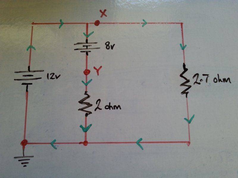

Hi gneill,
Thanks for the reply. I've attached a circuit diagram I've drawn with arrows showing the path of the current. Is this the correct path of the current? If so, then I would say there is a potential of 12v between the ground and node X.
Benthal said:
Hi gneill,
Your current labels are fine. But really you only need to find one path from the reference node to the point of interest for which you want to know the relative potential along which you can sum known potential changes. What path did you follow?

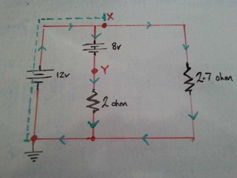

It'll be easier with diagrams, I've attached an image which shows the path I've chosen.
Yup, that's great. Well done.
