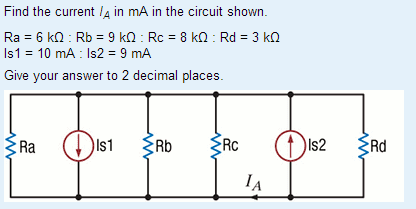

Currents entering the top node...
[itex]\frac{V}{6000} - 0.01 - \frac{V}{9000} - \frac{V}{8000} + 0.009 - \frac{V}{3000} = 0[/itex]
Solve for V I get -2.48
The current Ia is the addition of the current going out of Rd add Is2
so... [itex]I = \frac{2.48}{3000} =0.000823 [/itex] Therefore.. [itex]I_{A} = 0.000823 - 0.009= -0.008172 [/itex] This is wrong... the answer is -9.45mA and I get -8.17mA
Anyone care to help me out!
Check the sign on the first term of your KCL equation...
