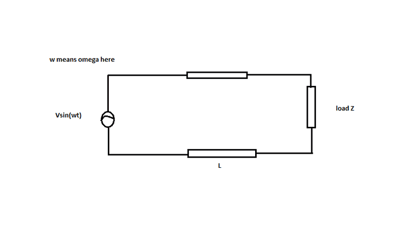

duniltmg1 said:I have found out that kirchhoffs voltage law and krichoff's current law are only vaild when the wavelength (λ) << L.
are there any other circumstances??
Kirchhoff's Laws are fundamental principles in electrical circuit analysis that describe the flow of current and voltage in a circuit. The first law, also known as Kirchhoff's Current Law, states that the sum of currents entering a node (or junction) must equal the sum of currents leaving that node. The second law, known as Kirchhoff's Voltage Law, states that the sum of voltages around a closed loop must be equal to zero.
A transmission line equivalent circuit is a simplified representation of a transmission line that allows for easier analysis and modeling. It includes lumped elements such as resistors, inductors, and capacitors, that represent the distributed properties of the transmission line. This model is used to calculate the electrical characteristics of the transmission line, such as impedance, voltage, and current.
Some of the most common violations of Kirchhoff's Laws in transmission line equivalent circuits include the presence of stray capacitance and inductance, mismatched impedances, and reflections. These violations can lead to inaccurate calculations and affect the performance of the transmission line.
To identify Kirchhoff's Law violations, you can use simulation software or perform calculations using the transmission line equivalent circuit. If the calculated values do not match the expected values, it may indicate a violation. To correct these violations, you can adjust the values of the lumped elements in the equivalent circuit or make modifications to the physical layout of the transmission line.
Kirchhoff's Laws are fundamental principles in circuit analysis, and violating them can lead to incorrect calculations and inaccurate results. In a transmission line, violating these laws can also affect the performance of the line and lead to signal degradation and loss. Therefore, it is crucial to ensure that Kirchhoff's Laws are followed in the equivalent circuit to accurately model and predict the behavior of the transmission line.
