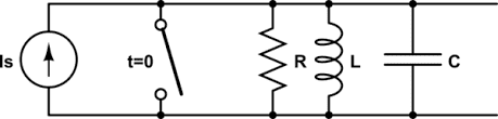

Consider the circuit from minute 6:57:
So I have an electric field there everywhere in the loop and I can write integral of E*dl as being v and I end up with kirchhoff's rule. (you don't have to watch all the video to respond to this question, just the circuit)
But what if I had an ideal current source in series with a resistor? How do we write integral of E*dl in a closed loop in this case? Do we even have an electric field inside the current source?
If not, how do we reconcile the current source with kvl?
