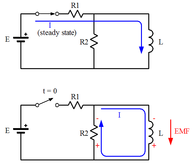

Also, when does an inductor supply voltage? When it was 'charged' up by an emf source and that emf source is disconnected? If an inductor is hooked up to a resistor, does kirchhoffs law predict L di/dt = IR? Ldi/dt - IR = 0? I'm imagining an inductor and resistor in parallel, being charged up, and a switch opning disconnecting the battery from the inductor and resistor. The thing is, when I do that approach and do the math, I get I = I(0) * e^(tR/L), which predicts the current goes up, not down... What's going on here? I try to justify my initial set up because when switch is opened, current weakens, inductor as a response supplies an emf in direction of original current (meaning potential is gained?).

So when a switch is opened (in a circuit I described in OP), the magnetic field through coil weakens and the inductor will provide an emf(+V). I checked the units and they appear to be okay. Time constant (seconds) = L/R. L * A = A*s*R, L = S*R, L/R = second. So the dimensional analysis works out. It's just my answer is off by a factor of negative one and I want to know how to justify, conceptually, why I should have -L di/dt = IR instead of L di/dt = IR. Kirchoff's law states, go around in a circle back to original point, sum of potentials should be 0. Okay, Start before inductor, trace towards inductor, inductor provies emf (+L di/dt), find my way to resistor which drops the potential (-IR), back to where I am, the sum should be 0, L di/dt - IR = 0, But this is wrong. For me to get the right answer I need to have -L di/dt - IR = 0.
I am not sure that Kirchoff's law is the right approach here. Your equation for the exponential decrease in I (current) should have a minus sign in the exponent i.e. I = I(0) exp ( - tR/L). This is because a back e.m.f. retards the rate at which the inductor discharges. The e.m.f. acts to oppose the change causing it and so will be in the opposite direction to current flow, so I believe IR = -Ldi/dt.
I don't know any other way to set up the equations other than use kirchhoffs law.. If there was no inductor, the current through the resistor would pretty much instantly go to 0. But with an inductor, shouldn't it supply a potential which is why it takes a lot longer for the current to die out? Current weakens through inductor which forces inductor to supply emf in the direction of weakening current right?
Using kirchhoffs law, it comes off as if there's a drop in potential for both the resistor and the inductor, which I do not understand.
Here's an example circuit for discussion. In the top figure circuit is at steady state and some steady state current ##I## flows through the inductor. At time t = 0 the switch opens. The inductor will not allow its current to change instantaneously, so the current size and direction if the inductor current must remain the same for that instant. This is depicted in the second image.
The inductor produces an emf as indicated to drive the current. When you "walk" the circuit in the direction of the current flow this appears as a potential rise. The resistor, on the other hand, shows a potential drop in the direction of the current.
That's how I currently am thinking about the situation. But when I put when you just described in numbers, I get an incorrect formula. When you "walk" the circuit in the direction of the current flow thiis appears as a potential rise (+L di/dt), the resistor shows a potential drop in the direction of the current (-IR), add them up and you get 0. L di/dt - IR = 0, l di/dt = IR, but that equation is wrong and implies current goes up over time, not down.
Ah. I see where the confusion comes from, and it is indeed a bit tricky. Note the direction of I. If dI were positive (increasing the current) then it would create an emf that is opposite to what is observed. That is, a positive dI would make the top of the inductor positive and its bottom negative. For the given current direction then the dI must be negative: the current is decreasing.
For the current direction shown, the emf that is depicted across the inductor is thus given by L (-di/dt) or, -L dI/dt.

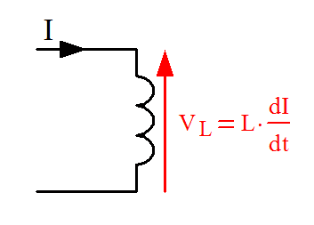

So the tricky bit is relating the sign of the dI to the current direction and the resulting polarity of the emf. Recall how the emf for an inductor is defined:
where the defined direction of the emf (red arrow) assumes dI/dt is in the same direction as the current.

dI is taken to be positive for increasing current. The potential created in the inductor as a result is L di/dt, positive, with the orientation as per the definition:
"Walking" through the inductor in the direction of the current then gives you a potential change of -L di/dt, so yes.

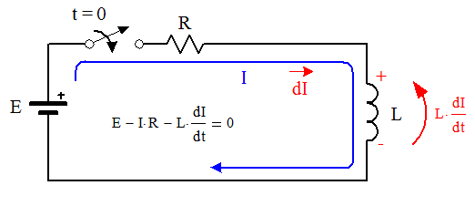

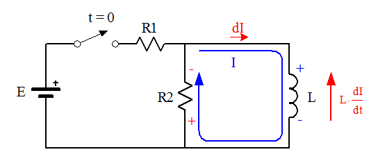

When you write the KVL equation you can sketch in the "actual" polarity that would occur if the current under consideration were to increase. Then when you do your "KVL walk" around the loop you can treat that potential change as a rise or drop according to the direction that you "walk" around the loop. Going back to the example, sketching in the inductor emf due to a positive change in the loop current:
If the current increases by ##dI## then the resulting polarity of the emf is shown as the blue +/- sketched in on the inductor. So an increase in ##I## results in a potential drop across the inductor (going clockwise around the loop). This is what mathematically ties together the sign (direction) of the current and the change dI to that current and the resulting emf on the inductor.

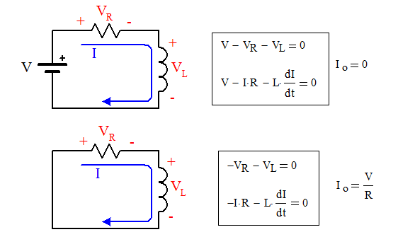

The same logic holds for the battery - resistor - inductor circuit:

I think I agree :smile:. The best policy is to trust the math and always assume that di is positive and in the direction of the current flow. Then indicate the resulting potential that it would create on the inductor. Use that indication as the potential change that you encounter on your KVL walk. The rest of the equation will take care of what actually happens, just as when doing regular circuit analysis you assume a current direction and find out later that you "guessed" wrong when it turns out to be a negative value. The math will take care of itself if you stick to the basic definitions.

I'd say that there's too much thinking involved :smile: Just always assume that di is positive in the direction of the assumed current and sketch in the resulting inductor emf due to that positive di. Respect that potential's polarity when you do your "KVL walk".
In the following diagram assume that some unseen switching action is setting up the conditions. In the top diagram the initial current is zero when the battery is connected at t = 0. In the bottom diagram there's an initial current Io at t = 0. The potential changes due to the assumed current (with its assumed positive di in the direction of the current) are sketched in as VR and VL. The KVL equations are written accordingly, walking clockwise around the loops. Then ##I R## is dropped in for VR and ##L \frac{dI}{dt}## for VL.
So at the end of the day, if you're only given -L di/dt you have no idea whether it's referring to a drop or a gain? Just depends on context? If what I'm saying is right, then what you were saying earlier makes a lot more sense now. Either that or I convinced myself I'm right with the wrong reasons xS. Wouldn't be the first time.
Just set your current direction and allow the di to be positive in the direction of the assumed current. Then as far as your equations are concerned you'll always have a "drop" of L di/dt in the direction of the current.
