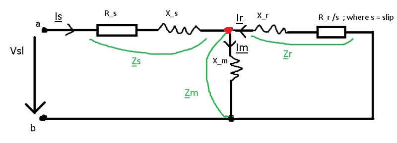

Find currents Is (stator current), Ir (rotor current) and Im (magnetic current)
Kirchoff's Law
Ohm's Law
Hi,
Please find attached below the Induction Generator circuit.
I have the following parameters:
ParameterValue
Rs = Rr (Resistance on stator and rotor)0.2 Ω
Ls = Lr (inductance on stator and rotor)5 mH = 0.005 H
p (number of pairs of poles)2
f (frequency)60 Hz
Vsl (stator line voltage) - delta connection220 V
s (slip of the generator)-0.02
I am requested to find the currents.
Kirchoff's Law Im = Is + Ir
$$Is = \frac{Vsl} { Zoverall} $$
$$Zoverall = Zs+Zparallel$$
$$Zs = Rs+iXs = 0.2+1.8849 Ω $$
$$Zm = iXm = (0+37.6991i) Ω $$
$$Zr = \frac {Rr} {s} + iXr = (-10 +1.8849i)Ω $$
$$Zparallel = \frac {Zm*Zr} {Zm+Zr} = \frac { (0+37.6991i)*(-10 +1.8849i)} {(0+37.6991i)+(-10 +1.8849i)} $$
$$Zparallel = (-8.5261+3.9490i) Ω $$
Hence $$Zoverall = Zs+Zparallel = (0.2+1.8849 Ω) + (-8.5261+3.9490i) Ω $$
$$Zoverall =(-8.3261+5.8339i)$$
$$Is = \frac{220V} {-8.3261+5.8339i } $$
$$Is = (-17.7222 -12.4175i) A = 21.6395 A$$
Now we have to find currents Ir and Im
$$Vs = Is*Zs = 21.6395 A *1.8954 Ω = 41.0172 V$$
$$Vm=220V-Vs = 220V-41.0172V = 178.9828 V$$
$$Im = \frac {Vm} {Zm} = \frac {178.9828 V} {(0+37.6991i) Ω}$$
$$Im = (0-4.7476i)A = 4.7466 A $$
$$Ir = I am - Is = (0-4.7476i)A - (-17.7222 -12.4175i) A$$
$$Ir = (17.7222-7.6699i)A$$
$$Ir = 19.3107 A$$
Do these calculations for I am and Ir make any sense? Current through the stator (Is) seems to be all right, but I'm not sure if what I did to calculate I am and Ir makes any sense.
Can we say m and r branches are in parallel?
I would be more than grateful if someone can check the calculation for I am and Ir.
Many thanks!
Where does ##Xm## come from? You didn't list an inductance value above. I presume, given the value, that it corresponds to a 100 mH inductance?

gneill said:
Where does Xm come from? You didn't list an inductance value above. I presume, given the value, that it corresponds to a 100 mH inductance?
Yes, that's right, sorry about that the Lm = 100 mH so Xm yields 37.6991,
so the impedance Zm = (0+37.6991i)Ω

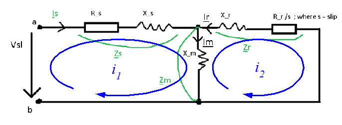

Considering that the circuit represents a generator, it is not unreasonable to find that it produces a current "out" of terminal a.
I can confirm that ##Is## as labelled on your circuit diagram has negative component values as you've found. I used mesh analysis to find the currents:
In the above diagram ##Is## is identified with mesh current ##i_1##, ##Ir## with ##-i_2##, and ##Im## is given by ##Im = i_1 - i_2##.

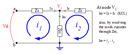

Thanks again for the quick reply, I got I am = Ir - Is so I get I am = -i2-i1, perhaps I'm doing something wrong
Martin Harris said:
Hi
With the current directions you've defined in the diagram, KCL at the node would yield I am = Is + Ir, no?
Note that ##i_1## flows in the same direction as Im, while ##i_2## flows in the opposite direction. So ##Im = i_1 - i_2##.

Which turns out to be true.So I am = Is+Ir, right? I am = -Is + Ir, is wrong?
Correct. To summarize the situation in a diagram,
Likes Martin Harris
Brilliant! Thank you! That's neat!

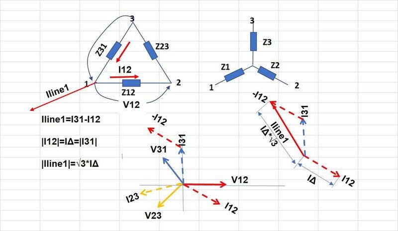

Given the same circuit schematic as above
What I don't understand is...say for example we have the Voltage on the stator line Vsl= 380 V
Then if the connection is delta, Voltage on the stator line = Voltage of the stator phase = 380V, right?
Vsl = Vsph = 380V
When I calculate the electrical currents as phasors I get
$$Is = Voltage / Zoverall = 380 V/ (-8.3261 + 5.8339 i) Ohms = (−30.611156228−21.448508224i) A$$
$$Is = 37.3772 A$$
this current Is is phase or line current? I am tempted to say it's a phase current so no need to divide it by sqrt(3)
If Zs,Xm,Zr are the actual windings data and stator is Delta connected then:
If Vsl=220 then Is=21.58 A
The line current will be sqrt(3)*21.58=37.38 A
If Vsl=380 then Is=21.58*380/220=37.38A
The line current will be sqrt(3)*37.38=3*21.38=64.14 A
Likes Martin Harris
Hi
Thanks a lot!
What if Vsl = 380 V in Delta connection?
Is = 380V / Z_ab (overall impedance) = phase current, right?
In that case I don't have to / sqrt(3) to get the phase current, as I already have it calculated
Iline=IΔ*√3
