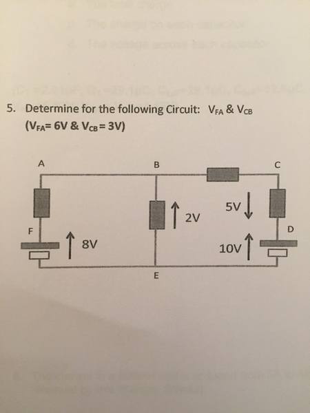

I am trying to complete a mock paper for an upcoming assessment. The mock comes with the answers supplied in bold under the question yet I am having trouble understanding how the answers are obtained. I know that the law states that the sum of all emfs equals all the sums of the voltage drops and i have looked at several online articles but they seem to be very complex for what I need to understand. I am hoping someone can explain using the example I have. I am not sure how the arrows play a part in this either
EDIT: After much banging my head i have come up with the following.Can someone comment if this is correct and if there is a more excepted way of writing it out:
ΣV=0
B-E = -2V
E-D = +10V
D-C = -5V
BE+ED+DC = +3
∴ C-B = 3V
And
ΣV=0
B-E = -2
E-F = +8
A-B = 0
BE+EF+AB = +6
∴ F-A = 6V
The arrows depict a change in potential, increasing towards the arrow head. So for example, the arrow on the battery in the left bottom corner depicts an 8 V rise in potential across the battery going from node E to node F. Similarly, on the resistor connected from E to B there's a 2 V potential increase.
Kirchhoff's voltage law states that the sum of the potential changes around a closed path is zero.
Ive updated what i think is correct! If anyone can confirm
Looks okay.
gneill has already mentioned this but it's far better to think...
and start by writing equations that sum to zero. For example you wrote..
BE+ED+DC = +3
I find I make fewer mistakes with the signs if I specify where I'm starting and write my equation to sum to zero like this..
Going anticlockwise from B..
BE + ED + DC + CB = 0
and then rearrange it to solve for the unknown CB.
