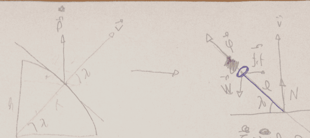

I am not sure about a, but i think as long as there is no torque about the Lp direction, it will remain constant with relation to the polar star. I would like help in proof this mathematically.
I just don't know how to proceed, i wonder if i would need to consider the torque provide by Centrifuge and Coriolis force, well... It made me wonder if I'm really on the right track.
p is a vector pointing polar star
v is a vertical vector.
Lambda is latitude
W is weight
fcf is force centrifuge
N is reaction in a pivot
You don't need any formulas for this.
What is the basic characteristic of the spin axis of a (gimbaled) gyroscope?

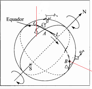

Now pretend you point the gyro axis at the specified angle on a globe. Rotate the globe to simulate diurnal spin.
What has happened to the gyro spin axis, looking at the globe?
What if you are at latitude 45 deg. and you point the gyro spin axis horizontally instead of latitudinally along the Earth's polar axis?

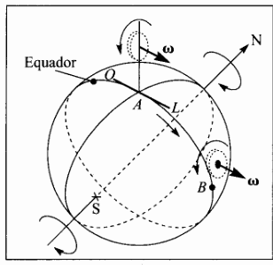

In your diagram, with the gyro axis initially EW, the observer sees the axis swing to vertical. What would the observer see if the initial axis were NS?
Not sure, i got struck in that thought, but seems the gyroscope always will point in the same direction.

Yes, but the observer doesn't.

The question says nothing about using it to find true north. I don't think it would be a very practical method.
But to word it more precisely, the axis will only appear stationary in the reference frame of an observer on the Earth's surface if it is aligned to true north.
