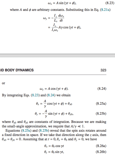

Hi all.
I ended up to this section in K&K (2nd edition, but with 1st is the same) when they derive the wobbling motion of a simple body in torque-free precession. [see the attached file]
Equations 8.23 and 8.24 are integrated into 8.25[a|b], but I think signs are wrong. Shouldn't be negative cosine in 8.25a and positive sine in 8.25b ?
Another problem is that equations 8.26[a|b] have the same sign, shouldn't they be opposite ?
This is the second edition of the book so I'm doubting if I'm tired and missing something.
Thanks in advance.
There are obviously inconsistencies in this concerning the signs. Given (8.23) in the next line (un-numbered equation) the sign is already wrong, because
$$\dot{\omega}_x=+A\gamma \cos(\gamma t+\phi).$$
