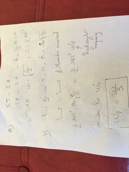

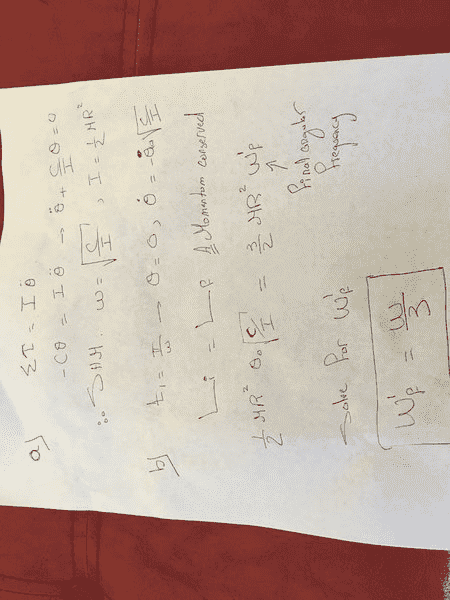

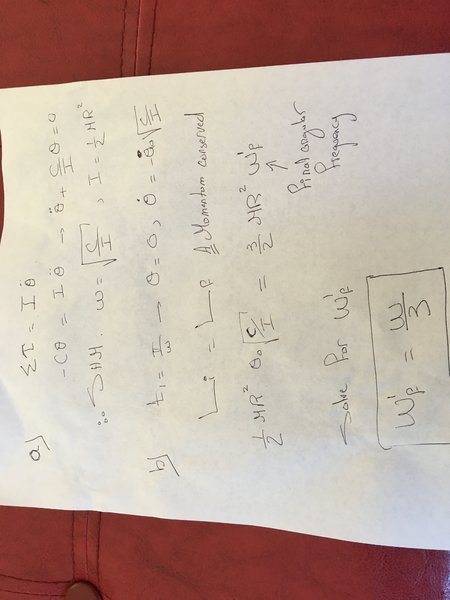

Solution only uses change in I to arrive at w. I did part a no problem there but for frequency I am not convinced. Why not:
Li=Lf then wi*Ii=wf*If. only unknown is wf but then you get w0/3 not w0/√3

Hello,
Sure attached
MARX said:
Hello,
Sure attachedView attachment 228751
If you must post working as an image (images are for diagrams and textbook extracts - read the guidelines), please ensure it is the right way up!
As I suggested, you are confusing the angular frequency with the instantaneous rate of rotation.
The angular momentum at time t is Idθ/dt. This varies. You are asked for the new angular frequency, which will not vary with time.
You can ignore whatever was going on before the putty hit. Just calculate the angular frequency of the disc+putty system from scratch.
