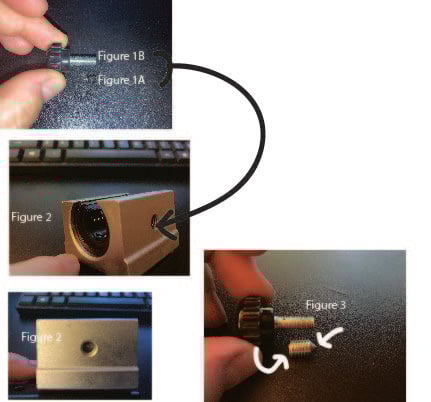

hi, I am having an issue with a knob-like screw. the original screw, seen in figure 1 A tigthens the hole in the figure 2 very good, but I tried to replace it with a knob like the one in Figure 1B, but it does not tighten right. both are an M6 type. I tried similar knobs like Figure 1B in sizes M5, M4 but are too thin. Does anyone know why Figure 1A screw tightens good but not the one shown in Figure1B? even both appear to be from same size and get into the whole ok?
Does anyone know if a knob of M6 size with a pointy ending like shown in Figure 3 exists? I don't know how to search it...what name to use...
thank you
Could be possible that the original screw is 1/4"-28 crests per inch rather than M6-1.0 mm?
Likes BillTre and Tom.G
Here is how to tell.
Hold onto the knobs, hold the original in one hand and the replacement in the other.
Bring them together side by side so the full length of the threads of one mesh with the threads of the other one.
If the threads do not mesh perfectly uniform over their full length, then they are different threads.
The other possibility is that the item with the female thread is damaged and the original threaded knob is worn enough to mostly work.
Cheers,
Tom
p.s. Differing male+female threads often mate 1/8 to 1 turn then stop, that is another clue.
Likes BillTre and Lnewqban

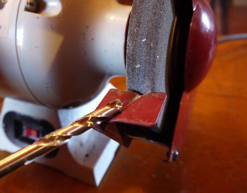

Grinding small screws:
  • Skeptical
  • Love
Likes BillTre, Rive and hutchphd
I think the point needs to be precisely centered for this role.
What does "precisely" mean quantitatively? How good is your handiwork? If you can rotate the piece while grinding this can be quite precise.... or touch it up at the finish somehow by rotation.
My bench grinder has a guide for grinding drill bits. You can see it in the image from my previous post, but you see it better in this next image.
It might be more difficult to use with a short screw - especially with a large head - but I'm sure a resourceful person will manage to find a way to make it work.
Likes berkeman, Tom.G and BillTre

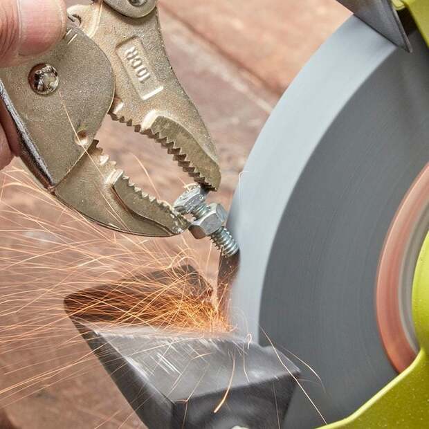

You can chuck it into a drill and turn it while against the grind stone. Thread a nut on to improve the grip.
Likes jack action

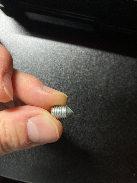

thank you for all the comments, but I tried the angle grinder and is not effective. Does anyone know if there is a special tool to create this pointy thing in a reproducible manner? Any tool or cap that would insert into the end of the tip and make it pointy grinding it? thank you
Possibly you could reconfigure a valve grinder to do something like that.
but does anyone know whoever did this point thread, what machine they might have used? its very symmetrical.

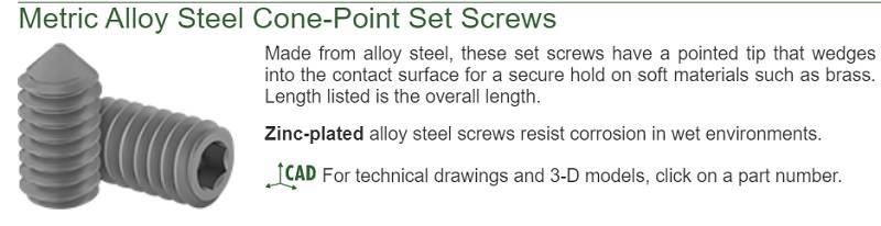

You can buy metric setscrews with pointed ends:
And you can buy knobs in a variety of sizes and shapes to fit the metric setscrew:
Buy a setscrew and a knob, put some Loctite or 5 minute epoxy into the knob, and screw in the setscrew. McMaster-Carr has pointed tip M6 setscrews in lengths from 6 to 60 mm, so you should be able to find a length that works.
The above images are screenshots from the McMaster-Carr catalog: https://www.mcmaster.com/. McMaster-Carr is THE best source for DIY people looking for small parts. They are an industrial supplier that specialize in small orders, and do not care if the customer is a big company or an individual.
Likes Nik_2213, hutchphd, berkeman and 1 other person
thank you. this might be helpful. I really appreciate the input. But still: how they make the cone-point screws?
Something like I described in the above quote I would assume except properly fixtured similar to a valve grinder.
Because it has a socket head, it cannot be produced from a long bar in a repetition lathe. It will need to have the hex socket formed hot, then the thread rolled and material heat treated.
I would lock a couple of hexagonal nuts onto the thread, then hold it by those nuts in the three-jaw chuck of a lathe. I would then cut the conical point in the hardened material with a carbide cutter.
An alternative would be to use a cylindrical grinder, rather than a lathe.

sophiecentaur said:
The picture in post #1 looks like it's from an astronomical device (holding a small optical tube? - are those rough dovetails at the bottom?)
No, that is an open, linear-motion, bearing block, with circulating bearing balls.
The central side screw, is a clamp, used to lock the block in place. There should be an internal puck that is pressed against the rail when the clamp screw is tightened. The puck prevents the end of the clamp screw from damaging the surface of the precision-ground rail that the block runs along.
The clamp screw should have a polished flat end that presses on the puck. A sharp point would penetrate and split the puck, then damage the rail.
Likes Tom.G, Nik_2213 and sophiecentaur
  • #34
I made a similar comment; used the wrong word, though.
So you are saying that minimal force is needed to locate the bearing block in the tube (it's full of bearing balls so very little lateral force needed).
I have to ask WHY the OP needs to do any periodic adjusting, then. It's a bit of a muddle / mystery.
Likes Nik_2213
  • #35
The bearing block contains the recirculating balls, and runs on a cylindrical rail. The polymer insert that guides the balls is held in the block, by an internal circlip at each end. End-play of the polymer insert in the block is not critical in a linear bearing. When the clamp is tightened, the end-play is also clamped. The clamping force is applied to the cylindrical rail through the polymer, between two lines of rolling balls.
For an M6 clamp screw, the holding force along the rail is about 30 N, with a torque on the screw of about 0.8 Nm.
