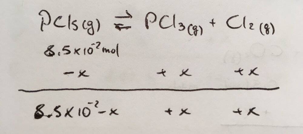

Yes I've done it: but i am not understanding how to get x, usually Kc or Kp or partial pressures, or molar fractions are given, but here ?
sorry for posting a pic btu i did not know how to draw it here
ok now i got it, yesterday i was too tired to see it 😅. Basically what I do is.
##8,5*10^{-2}-x+x+x= 8,5*10^{-2}+x=n_{tot}##
so
## n_{tot}=\frac{P_{tot*V}}{RT}##=0,125mol
##8,5*10^{-2}+x=0,125mol##
##X=0,125-8,5*10^{-2}=0,04 mol##
now I just plug in Kp equation and done
