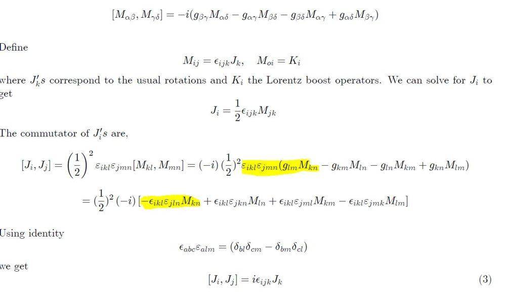

I know what I need to do but I am stuck on one of the steps
Levi-civita and Kronecker delta identities
εikl εjmngkmMkn =
εikl εjknMkn = (in book it changed sign to -εikl εjknMkn - Why? )
By identity
εikl εnjkMln = inδkj - δijδkn)Mkn = ?
I then get ..
Mji - δij Mnn ( is this correct ?)
There 's more to the question but if can get this part right, I should be able to complete the rest.

Oops I had not read carefully. What you wrote as the first expression can't be right! Note that you have three indices "k", which is incorrect. Check what the correct answer is.

This is a bit confusing because normally using the metric should raise or lower the indices, but here all your indices are downstairs, so I am not sure what the convention is, here. Yes, those steps are correct.
Thanks very much, I have just finished that part of the question and it worked out. I was not confident of what I was doing but I am now.
The fact that there were only lower indices confused me too, I vaguely remember my lecturer saying because its Minkowski space, contravariant and covariant are the same, might have heard that wrong though.

AH ok. But the very first expression you wrote was incorrect, right? It had three times the index "k".
OP,
Go back and look at your expressions carefully, from the beginning, you've made errors in copying from the problem.

Now I see that the contravariant and covariant metric tensor are not the same. x0 = x0 and xa = - xa with the (+,-,-,-) metric we used. The same lecturer also teaches classical mechanics and it was during this class, when I think he said there is no difference between the contravariant and covariant indices. He may have mentioned flat space and I took this to mean (without thinking about it enough) Minkowski space.

Minkowski space is flat, so he probably didn't say flat space, I would bet that he said Euclidean space.
