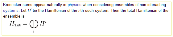

The question arises from this quote from wikipedia's article about kronecker product:
Kronecker sums appear naturally in physics when considering ensembles of non-interacting systems. Let Hi be the Hamiltonian of the i-th such system. Then the total Hamiltonian of the ensemble is
I have to write this Htot as a ordinary sum over kronecker products of unity matrix and Hi-s.

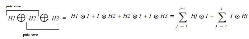

Well, as I undesratnd, now instead of A and B we have simply Hi and there should be sum kind of sum over i. But the Kronecker sum is defined only for a pair of matrices and it isn't commutative, so the order is important. I tried something like this, for three H-s:
But it doesn't look very elegant and I have no idea if this could be true. Any advice?

The definition is as follows
[tex] H_{\text{Tot}} =\left( H_1 \otimes \mathbb{I} \otimes \mathbb{I} \otimes ... \right)+ \left(\mathbb{I} \otimes H_2 \otimes \mathbb{I} \otimes ... \right) + \left(\mathbb{I} \otimes \mathbb{I} \otimes H_3 \otimes ... \right) + ...[/tex]
Are you sure? Thank you!
Proof:
Kronecker sum is associative.
In other words.
The Kronecker sum of two matrices is, as you wrote,
[tex] X=A\oplus B = A\otimes\mathbb{I}_B + \mathbb{I}_A\otimes{B} [/tex]
Now, since the sum ##A\oplus B## is a matrix, ##X##, the Kronecker sum
[tex] Y= X\oplus C = X\otimes\mathbb{I}_C + \mathbb{I}_X\otimes C = (A\otimes\mathbb{I}_B + \mathbb{I}_A\otimes{B})\otimes\mathbb{I}_C + \mathbb{I}_X\otimes{C} [/tex]
Of course ##\mathbb{I}_X=\mathbb{I}_A\otimes\mathbb{I}_B##, which gives
[tex] Y= A\otimes\mathbb{I}_B\otimes\mathbb{I}_C + \mathbb{I}_A\otimes B\otimes\mathbb{I}_C + \mathbb{I}_A\otimes\mathbb{I}_B\otimes{C} [/tex]
##Z= Y\oplus D = ## Keep going... :)
