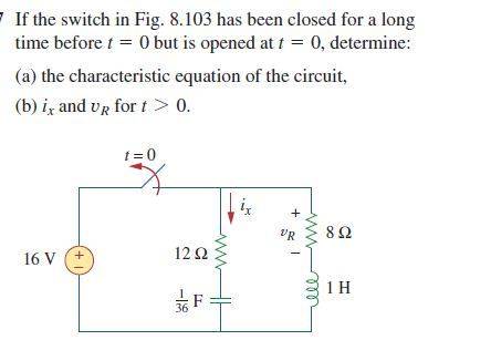

KVL for a RLC circuit given current direction and polarity of a resistor?
Here is the diagram of the circuit:
KVL
Sum of voltages equal zero
I am actually looking for the voltage across the inductor (VL), so I decided the best approach in finding it is through Kirchoff's Voltage Law.
Being given the polarity of the resistor, should I follow the passive sign convention for the other components in the circuit while doing KVL...if I decide to do a loop in the counterclockwise direction?
I understand that current conventionally flows through the positive terminal to the negative.
So would it be correct if I label the circuit like this, if I did a KVL mesh counterclockwise?:
Any help would be appreciated, thank you. :)

What about voltage source? Where is it placed in the diagram? If RL branch and RC branch are in parallel to the voltage source, you can analyze them independently.
Well, this is the original problem...I've done part a) already, but I'm at part b) trying to find the general equation for i_x(t)...and to do that I need to find the inductor voltage when the switch is open--since I'm solving for the initial conditions di(0+)/dt and that equals VL/L.
Was just wondering if my polarities/KVL is correct in the diagram above? :frown:
Was just wondering if my polarities/KVL is correct in the diagram above? :frown:View attachment 95472
If the switch was closed for a long time, the capacitor must be charged to 36V. Is the direction of Ix given in the problem or you assumed it?
Edit:sorry I didn't see the diagram, it is given in the problem itself.
Ix is given. I don't think the capacitor will be charged to 36V. t=0- , capacitor should be 16V.
You should reverse the direction of Ix. It is not possible for given polarity of the resistor.

Oh why is that...if you don't mind me asking? The resistor polarity was given as positive on top and negative on bottom. I figured if I did KVL and followed the polarity of that resistor, then I would be on the right track.
After opening the switch, the capacitor will discharge. So, the current direction should be from +ve plate to -ve plate. Polarity of the resistor is correctly shown. You can change the direction of Ix or consider the magnitude of Ix as -Ix.

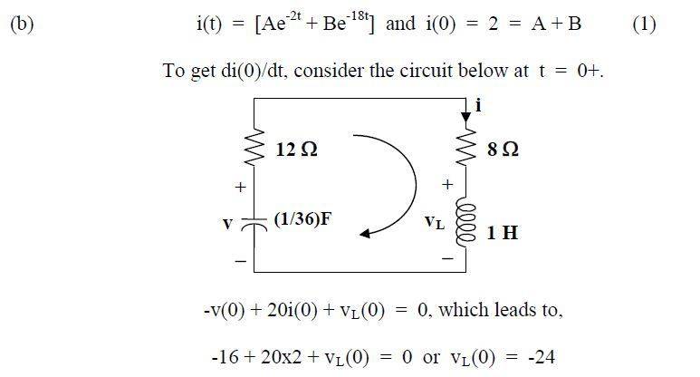

This was the solutions to the problem...but I just wanted to understsand the polarity of the circuit itself. I'm guessing as you mentioned, since capacitor is discharing, I_X goes the other direction ? Sorry I'm still a little unsure about this..
cnh1995 said:
Right. But wouldn't the initial current direction be opposite to the given direction of Ix? I thought it would be easier to write KVL with the actual initial current direction. Hence I suggested to reverse the direction. After solving the equation, the response will be damped oscillations, but in the beginning, I thought it would be better to go with the actual direction of initial current.:smile:
Yes, the initial current must be clockwise as driven by the inductor's initial current. But that just makes Ix negative initially.

So you're saying that we can completely ignore the defined polarity of the resistor that was given? And do KVL from there?
cnh1995 said:
Right. Initial current goes in the other direction.
So if this was the case...shouldn't the capacitor's polarity be (+) on the bottom and (-) on the top? Since current is flowing clockwise this time, and should flow from positive terminal of capacitor to negative. The solutions seem to have it the other way around.
It is flowing from +ve terminal to -ve terminal.
And the polarity of inductor voltage should be reversed.
It's an interpretive label. At some point you may be asked to state what VR is at some particular time, or over time in general. You'd then use that label to interpret the result that you present. But you don't need that label or its implied polarity to solve the circuit for the current that flows.
Likes gracy
The potential and current labels on a diagram are merely there for interpretation purposes. They tell you how to (hypothetically) connect a meter to read a value for reporting a result. When you're solving the circuit you can introduce all your own currents and potentials and ignore the labels if you wish. When you report results that are to be interpreted in light of those labels, that's where they come into play.
Just leave the interpretive labels alone and solve the circuit. Then interpret the result in terms of those definitions.
Likes gracy and cnh1995

I appreciate your explanation-- I guess the sign convention has got me overthinking it. One question that still ponders me is if i_x was originally going downwards to the 12 ohm and capacitor, but now i_x is going the other direction due to the discharge of the capacitor, does this mean the capacitor voltage is now (-16V) and the 12 ohm's voltage is now (12*(-2)) ? Aside from not labeling the signs of the elements, should we also consider the signs of the values itself?
At t=0+, inductor and capacitor are acting as sources. So, if you model them as voltage sources, you'll see that potential gain takes place in them along the direction of current and potential drop takes place in the resistors. So, given the polarity of resistor, I believe VL and Vc should be negative if Vr is positive.
Likes Aristotle
The polarities of potential changes that you write down depend on your direction of "KVL walk" around the circuit. The actual potential changes across components does not depend upon this; they are what they are. You can choose to "walk" around the loop in either direction, and you'd "see" the changes happen with reversed signs.
Capacitor's generally don't change their charges instantaneously. What has happened in this circuit is that the capacitor charged up to some value and then current through the capacitor stopped. When the switch opened current once again began to flow, this time in the opposite direction of the current that originally charged the capacitor. The capacitor begins with the same physical potential across it. How you interpret it is up to the the direction of your "KVL walk" when you write your KVL equation.
Likes Aristotle and cnh1995

Interesting...that is somewhat starting to make sense to me now.. if I understand you correctly, "previously" when I_x was flowing down the 12 ohm resistor and capacitor, the capacitor's polarity remains (+) on top and (-) on bottom since current normally flows in the positive terminal. But while keeping in mind that the capacitor's voltage and polarity does not change instantaneously, the polarity remains the same. Right?
cnh1995 said:
I wish I had even 10% of your fluency!
Thanks! You're very kind.
The physical charge and potential on the capacitor remains the same (for that instant), yes. You write a term in your KVL equation based upon how you "walk" over that potential.

In that case, current flows out of the positive terminal when a capacitor is discharging then?
Also knowing that the voltage across the inductor does not change instantaneously as well, the polarity remains the same as when the voltage source was applied to the circuit before t=0 correct? (+) on top and (-) on bottom?
:wink:
Voltage across inductor does change instantaneously. Hasn't it changed from 0 to -24V instantaneously after the switch is opened? It's the current that doesn't change instantaneously. Hence, the polarity should be -on top and + on bottom, as I said in #18.

But then the current will go in the negative terminal of the inductor if the polarity is switched though?
  • #31
Inductor is acting as a voltage source. What is the direction of current inside a voltage source?
  • #32
Umm..the electric current through a voltage source is out of the positive terminal if it's supplying power.
  • #33
Right!
:wink:
It's the current that doesn't change instantaneously for an inductor. The inductor will produce any potential across itself required in order to maintain that magnitude and direction of current flow. That means the potential across an inductor can change instantaneously.
In this instance, just before the switch is opened the current was flowing downward through the inductor, and the potential across it was zero (steady state, constant current for an inductor). When the switch opens, the inductor "wants" to maintain the flow and direction of its current. So it reacts by producing a potential across itself that tends to maintain the status quo, driving the current in its current direction. The potential created can have either polarity depending upon the requirement to maintain that flow. In this case the potential would be higher at the bottom of the inductor than its top.
Note that components other than sources do not have inherent polarities. You can turn passive linear components end-for-end in a circuit and they will behave the same.
Yes. So shouldn't + be at the bottom?
Likes Aristotle
  • #35
gneill said:
Right!
Wow that makes sense now ! I just realized I got the terms mixed up between inductor and capacitor. Inductor's CURRENT doesn't change instantaneously, but its voltage can.
Thank you so much for being helpful gneill and cnh1995! :woot:
