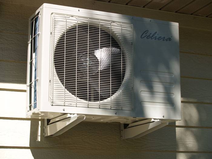

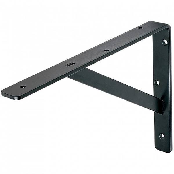

Hi all,
The photo is a reverse L-shaped bracket installed on the wall,
L or reverse L is of more supporting force if all things being equal? Why?
Thank you very much!

Ask yourself the question where the weight is derived.

I don't know what a "reverse" L-bracket is. Your pictures show a reinforced L-bracket and a non-reinforced L-bracket, so the answer to the question of which one is stronger seems kind of obvious, no?

It depends upon what you mean by "stronger'. If you are talking in terms of ability to support a similar load using the same screws at the same points in the wall, the forces on the screws would be identical (as long as the unsupported l is strong enough not to deform and as long as the weight of the bracket can be ignored).
If you are thinking in terms of the strengths of the two structures then clearly the braced bracket would be much stronger because the naked L has to rely on the corner joint alone.

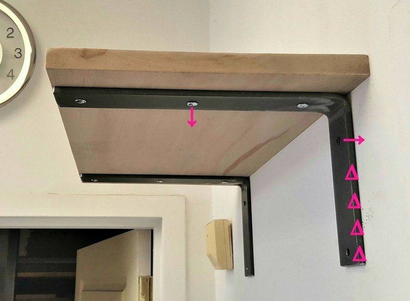

If fixed into wall material with screws, I see the Achille's heel here to be the topmost screw in a supporting L bracket (inverted L). That will be first to pull out of the wall as load on the shelf is increased. For a practical design to withstand maximum abuse, I'd favour the hanging braced L bracket above the shelf.
But the top most screw of an L design is equally at risk. The reverse L can be improved by a longer leg. A longer leg of an L design only increases the lever.

IMO, they are the same to within a few percent. If I understand what you are calling "reversed" (whether the letter "L" is upright or upside-down when viewed from the side), then the only consideration is whether you can cut slots in the shelf to accommodate the brace for the "upright L" version of the bracket.

A longer vertical of a hanging bracket decreases the leverage the load has on the screw, and for most home installations it's the weak strength of the wall as anchor for a screw that is the point of failure.

Yeah, right. What I meant was that the radius is larger and so the direction of the force on the screw is greater in its horizontal direction. To me the whole question is, how much force is supported by the wall in contrast to the screw. And that's why I favor the ##\lceil## because the wall beats the screw (I think - I should draw another picture though).
Your sample shows a strong bracket, so I conclude that the limitation in your proposed shelf resides in the uppermost screw's tendency to pull out of the typical wall material. For the sample supplied, I'd estimate the L support to be able to carry up to 3 times the load of the inverted-L, assuming the bracket itself doesn't break.
Rotating forces are shown, with the pivot point lying somewhere in the region of the ∆ markers, depending on flexure of the vertical arm. By my estimate, the load here has a leverage advantage over the screw's holding force of something like ×2 – ×5, meaning it looks like it could be much easier for the load to overcome the hold of the uppermost wall screw in this configuration.
