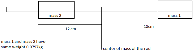

That is the set up for experiment, and I attached the data I found in the lab.
The lab given me the equation to find the moment of inertia of the cylinder
Icyl = (2hgM_cylinder) * (1/(W_withcylinder)^2 - 1/(W_nocylinder)^2)
The height is 0.9m
Me and my lab partner work separately and then we compare the Icyl value, in the attached file column J is his value, column K is my value and the two graph. I'm not sure which one is right, please explain to me what we did wrong?
And my graph (I cyl) doesn't look right too, please explain. Thank you very much

Your diagram shows two masses and a rod. Where does the cylinder come in?
What is the purpose of the lab? What is the procedure?
Are the distances in your diagram to the centres of the two masses? It looks like they're to the outside edges, but the mass widths are not given.

Are the distances in your diagram to the centres of the two masses? It looks like they're to the outside edges, but the mass sizes are not given.
I_Cyl is I_sys - I_rod.
I think by the moment of inertia of the cylinder they mean the moment of inertia of the two masses.

This equation is given in the lab manual to find I_cyl (I mis-typed in the post sorry)
where h is the height = 0.9 m (height from hanging mass to the floor)
M_cylinder mass of the cylinders = 0.0757 kg
W_withcylinder and W_nocylinder recorded by rotary sensor
I don't understand why the moment of inertia get smaller when the mass get bigger (the hanging mass act as a torque to make the rod rotating)
My partner (column J) has an entirely different number, and I have no idea where he got that equation from

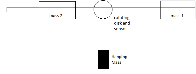

Ok, but what are they? At the least, what sort of entity: distances, times, speeds..?
The Angular velocity when the hanging mass hit the floor, I attached a better sketch
Sorry, I made a mistake in characterising the differences between the two equations. I missed a leading "1/".
The differences are:
- the constant 0.0797 I mentioned (M)
- col J is the inverse of col K
That is, col J is M/Icyl
