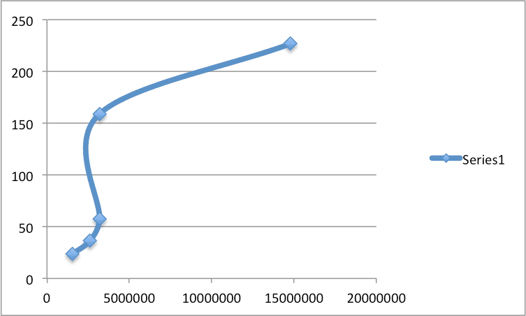

Basically my graph is throwing me off since it's not linear. Would it be incorrect if I take the most linear portion of the graph and calculate the slope manually from there, instead of adding a trendline and having excel do it?
Check calculations and add the zero point.
Unless I mucked it up myself, should be nice and linearish. Also, adjust your x scale, and do a best fit, instead of whatever that is. You should be okay, I think you just need to check the scale really and one number might off.
I agree with Student100. Your data looks good, but it appears that you didn't plot the data correctly.
Check the 4th data point in particular.

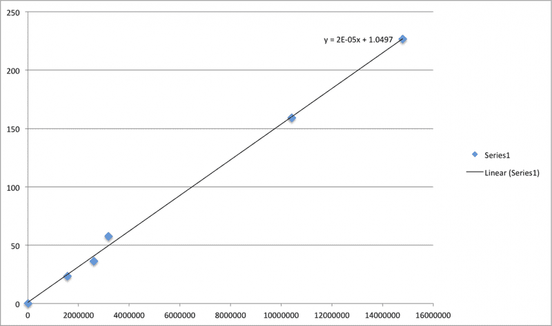

Student100 said:
Check calculations and add the zero point. View attachment 109069
That looks more like it... thank you so much for your help!

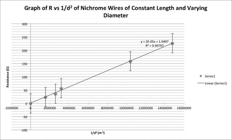

Does this look ok?
Student100 said:
Looks good to me.
I don't think we are required to add error bars but is it better to include them? Thanks again! :smile:
I would remove them then, I didn't check if they were right, and no sense to do so if not required.
