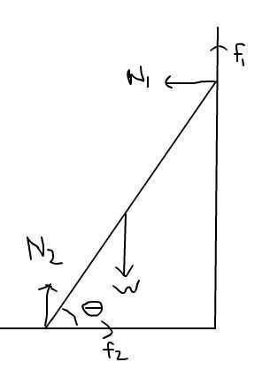

1. Homework Statement
A ladder on the rough floor is leaning against a vertical rough wall. The ladder has length l and mass m. The coefficients of friction are μ for both contact surfaces. What is the smallest angle between the ladder and the floor?
∑F=ma
∑τ = F⊥ r
fs ≤ μsN
[/B]
∑Fy = 0
N2 + f1 - W = 0
∑Fx = 0
f2 - N1 = 0
f2 = N1
∑τ about the ground = 0
N1lsinθ + f1lcosθ - W(l/2)(cosθ) = 0
For θ to be the smallest angle, what is the condition? Is it f1 = μN1 or f2 = μN2 or both of them need to happen at the same time?
Can the ladder move if the friction is static at some of the contact surfaces at the ends of the ladder?
I think the ladder can't move if one the friction is static. So both must happen at the same time.
Okay, I finally managed to solve it. θ = tan-1[1-μ2/(2u)]. Thanks ehild!

Are you sure that ##\theta= \tan^{-1}\left(1 - \frac{ \mu^2 }{2 \mu }\right)## ? Why you do not simplify with μ? Or some parentheses missing? :devil:
Oh it is a typo! Should be θ = tan-1[(1-μ2)/(2μ)]. Thanks anyway!
It is correct now. Nice work!
