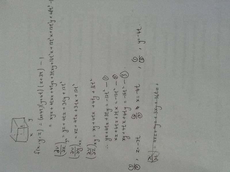

My answer for that is x=-4t, y=-4t, z=-3t.
I don't know what is wrong, since the t>0 , how can them be negative.
can you please tell me your answer? I will try again , please.
Sorry, what is the small t approximation version? can you tell me more please.

Show your work, so we can see where you went wrong.
I get
[tex] x = y = \frac{1}{3} 6^{2/3} \doteq 1.100642, \: z = \frac{1}{4} 6^{2/3} \doteq 0.825482 [/tex]
This is for ANY value of t > 0!.
Note, however, that the volume of metal used depends on the thickness, so if the sides and bottom have thickness 2t and the top has thickness t, we have:
[tex] \text{metal volume} = \left( 4t + \frac{1}{3} 6^{2/3}\right)^2 \left( 3t + \frac{1}{4} 6^{2/3} \right) -1.[/tex]

Only x, y z vary. Then t is constant.

Volume of metal used is xyz-1 ?

The volume of the box is xyz and it is given to be 1. That is not the same as the volume of metal in the sides of the box.
You expect us to read sideways? You never wrote your objective function separately. That is what you are trying to minimize. The point is that using an area density, the volume of a sheet of metal is density times area. It is the part of your formula with the with the ##\delta##'s, and it is the first thing you should have written down.
You were asked for the dimensions. You have them. And you get the volume of the box is xyz=1. If you want to calculate the minimum mass, put the values of x,y, and z in your objective function.

The objective function is ∫2xy+∫2yz+∫(xyz/2), where ∫ is the area density.
The constraint function is xyz=0.
So I am trying to minimize the mass.

Why would you say that? You quoted previous posts that had precise expressions given for the metal volume. Then you just ignored everything they said!
