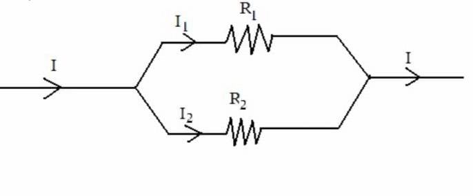

Suppose we have the following situation where a current I comes to a pair of resistors
in parallel (see picture below)
a)Determine what choice of ##I_1## and ##I_2## will minimize energy loss and hence determine
what the currents will be along the two paths. (Alternatively, if you already are
familiar with resistors in parallel and current flows, verify that the currents ##I_1## and ##I_2##
do in fact minimize energy loss).

Here's the picture, I didn't want to edit the original post because on my computer LaTeX messes up and I have to retype equations.
Check your math steps in going from
cwill53 said:
##\nabla f=\lambda \nabla g;2I_{1}R_{1}=\lambda ;2I_{2}R_{2}=\lambda ;I_{1}+I_{2}=I(constraint)##
##I_{1}=I-I_{2};I_{2}=I-I_{1}##
to
##I_{1}=\frac{2(I-I_{1})}{2R_{1}}##
Note that the last equation is dimensionally inconsistent.
to
I forgot to put the ##R_{2}## in the TeX. It’s there on my paper and I still got the question wrong.
With ##R_2## in place, you should get the correct answer.
Likes cwill53
It appears that I’m not getting the right answer however. Either that or what the solutions say is incorrect.
cwill53 said:
$$R_1 =\frac{IR_{2}}{I_{1}}-\frac{I_{1}R_{2}}{I_{1}}\Rightarrow I_{1}=I\frac{R_{2}}{R_{1}}-R_{2}$$
Check this. The left side of the arrow looks ok to me. But, the right side can't be right. It is dimensionally inconsistent.
Likes cwill53
Thank you so much for helping me see that. It’s always a slip up with the algebra!
Likes TSny
