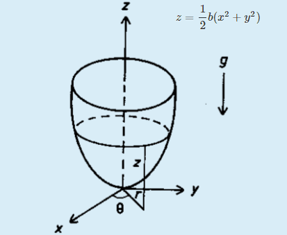

Hello. I solve this problem:
1. Homework Statement
The particles of mass m moves without friction on the inner wall of the axially symmetric vessel with the equation of the rotational paraboloid:
where b>0.
a) The particle moves along the circular trajectory at a height of z = z(0).
express:
- Lagrangian
- the equation of motion for the polar coordinate r
- energy of the particle (with m, z(0), b and g only)
- angular momentum of the particle (with m, z(0), b and g only)
b) We slightly deflect the particles downwards. Find the frequency of small oscillations around the original intact trajectory.

You should have two equations of motion, one for the ##\phi## coordinate and another for ##r##.
You should also have ##\ddot{\phi} = 0## in you EOM.
Edit: your equation (2) seems wrong to me you should be getting:
$$0 = (1+b^2r^2)\ddot{r} + 2b^2 r\dot{r}^2+gbr - r\dot{\phi}^2=0$$
But I don't see how you can find ##\dot{\phi}##.
Oomph! said:
Check the sign of the second term.
Apply the ##r## equation of motion to the special case of circular motion. (What are ##\dot r## and ##\ddot r## for this case?)
Note: Be sure not to confuse the angular velocity of the circular motion of part (a) with the angular frequency of small oscillations in part (b).
So first you can find a solution for your velocity of a circular orbit. Therefore you know ##\dot{r} = \ddot{r} = 0##. From your corrected equation 2 (what TSny wrote) you get:
$$r\dot\varphi = gbr \Rigtharrow v_0=\sqrt{gb}r_0$$
From the other equation you would get, if you've derived the Lagrangian for ##\varphi## you get, that you angular momentum ##L## is constant (central, conservative force).
$$L = m\dot\varphi r^2 = mv_0r_0 \Rightarrow \dot \varphi = \frac{\sqrt{gbr_0^4}}{r^2}$$
This is your expression of $\dot\varphi$ written in terms of the current radius ##r(t)## and the radius ##r_0## of the stable orbit. Putting this into eqaution 2 we get:
$$\ddot r(1+b^2r^2) - b^2r\dot r^2 - \frac{gbr_0^4}{r^3} + gbr = 0$$
Furthermore, for small oscillations we can say: ##r(t) = r_0 + \epsilon(t)## with ##\dot r = \dot\epsilon## and ##\ddot r = \ddot \epsilon## and ##\epsilon << r_0##. Furthermore every term with an ##\epsilon## of higher order than 1 is neglegable. This means ##\epsilon^2 = 0##, ##\dot\epsilon^2 = 0##,##\dot\epsilon\epsilon = 0## ... Doing this we get:
$$\ddot \epsilon (1+b^2r_0^2) - \frac{gbr_0^4}{(r_0+\epsilon)^3} + gbr_0 + gb\epsilon$$
With ##(r_0 + \epsilon)^3 = r_0^3+3r_0^3\epsilon + 0 +0 \approx r_0^3## because ##r_0^3 >> 3r_0^2\epsilon## which leads to the differential equation:
$$\ddot\epsilon -\frac{gb}{1+b^2r_0^2}\cdot r = 0$
So we get
$$\omega = \sqrt{\frac{gb}{1+b^2r_0^2}}$$ = \sqrt{\frac{gb}{1+2bz_0}}
I know I'm missing a 2 in front of the squareroot. I don't know where I lost it
