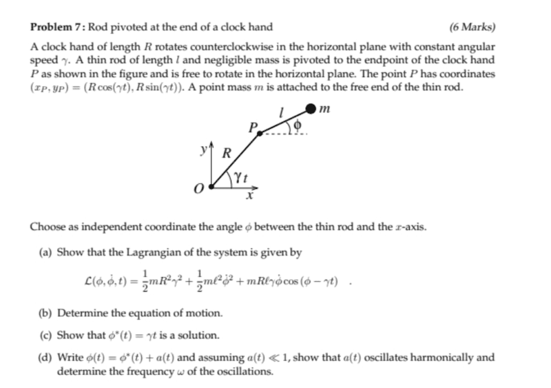

member 731016
Please see belwo
##ml^2\ddot \phi + mRl\varphi \dot \phi\sin(\phi - \varphi t) = 0##
For (d),
I am confused how ##a(t)## oscillates harmonically. The EOM is ##ml^2\ddot \phi + mRl\varphi \dot \phi\sin(\phi - \varphi t) = 0##
Then using ##\phi - \varphi t = a(t)##
##l\ddot \phi + R\phi \varphi a(t) = 0##
Where I used the small angle approximation after substituting in ##a(t)##
Does anybody please know where to go from here to find ##\omega##?
Thanks!
Simply linearise the equation of motion around ##\phi^*##. You have attempted this but need to double check your math.
Also note: It is ##\gamma##, not ##\varphi##.

Thank you for your reply @Orodruin!
##l^2\ddot \phi + Rl\phi \gamma a(t) = 0## is that please correct now?
Sorry I don't understand how you linearize the equation of motion around ##\phi^*##. I have not been taught that. Could you please explain a bit more?
Thanks!
No. Carefully consider the second term. Where did the ##\phi## come from?
It is essentially what you are (attempting) to do. You write ##\phi = \phi^* + a(t)## and then assume that ##a(t)## is small. Perform a Taylor expansion in ##a(t)## and keep only linear terms.
  • Love
Likes member 731016
Also, for the first term, you have not inserted the assumption ##\phi = \phi^* + a## ...
  • Love
Likes member 731016
I have solved the problem now.
EOM: ##l^2 \ddot a + Rl \gamma \dot \phi a = 0##
Angular frequency ##\omega = \sqrt{\frac{R \gamma \dot \phi}{l}}##
Thanks!
