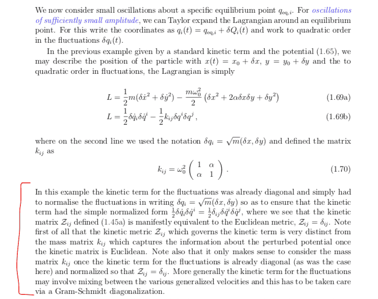

Can somebody explain why the kinetic term for the fluctuations was already diagonal and why to normalize it, the sqrt(m) is added? Any why here Z_ij = delta_ij?
Quite confused about understanding this paragraph, can anybody explain it more easily?
How can we answer this question, without knowing, what the example actually is? It's also mandatory to quote the textbook/paper you picture is taken from.
