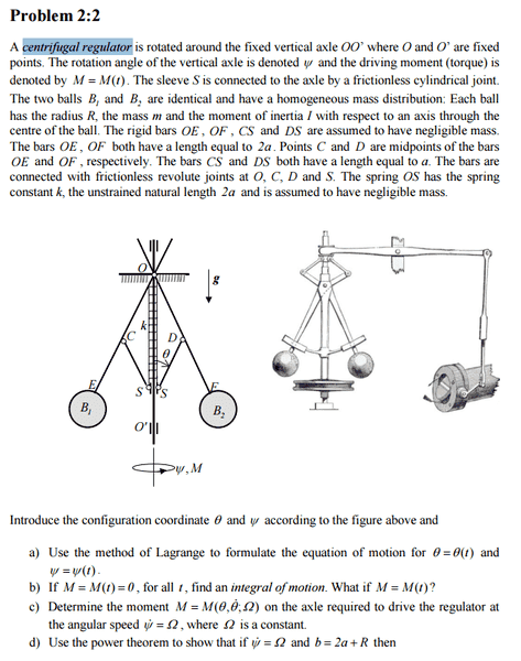

Lagrangian of a centrifugal regulator
In summary: If θ increases, both the spring potential energy and the gravitational potential energy increase.(3) The distance from the pivot to the center of mass of a ball.
dynamicskillingme

I got a forumla for the lagrangian as

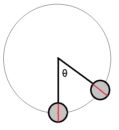

You have neglected the rotational inertia of the spheres about their centers. This will add additional terms to T. Also, check the sign of the gravitational potential energy part of L.

I don't believe the balls are allowed to rotate about their centers. Why wouldn't the gravitational potential be positive? Also this might just be me being ill but are these the correct L eq's
Each ball does rotate as either ##\theta## or ##\psi## changes. Consider a ball attached to the end of a stick as shown in the figure below. As the stick rotates through an angle θ, the ball also rotates through θ.
The potential energy is subtracted in the Lagrangian: L = T - V. You got the sign correct for the spring potential energy.

Yeah I agree with that, but what other term would that introduce?
Also wouldn't the gravity term be the opposite direction to the spring?
It's just a kinetic energy term due to rotation about the center of mass.

Check your text, or do a web search on "rotational kinetic energy". It involves the moment of inertia and angular speed.

In the potential energy of gravity term, the distance ##2a## is not quite the correct distance. You need to use the distance from the pivot ##O## to the center of mass of a ball.
In your Lagrangian you use the symbol ##l##. What does that stand for?

This is not quite the correct expression for ##l##. The ##R/2## part is incorrect. ##l## should be the distance from ##O## to the center of mass of one of the balls.
I won't write out what I get for the Lagrangian since this is your assignment. I have pointed out a few places where your expression for the Lagrangian is either incomplete or incorrect:
(1) Your first two terms represent the kinetic energy due to motion of the center of mass of the balls. In addition, you need to include terms representing the kinetic energy due to rotation of the balls about their center of mass as ##\theta## and ##\psi## change.
(2) The overall sign of the gravitational energy term needs correction.
(3) In the gravity term, you have not used the correct distance from ##O## to the center of mass of a ball.
To help with (1), consider how you would write the kinetic energy of a sphere of moment of inertia ##I## rotating with angular speed ##\omega## about an axis through its center.

That's getting very close to the correct ##L##. However, you need to include a rotational KE term associated with ##\dot{\theta}## as well as with ##\dot{\psi}##. And, as you say, the coefficient for the gravity terms needs to be corrected.
When evaluating ##\frac{\partial{L}}{\partial \theta}##, how did you get factors of ##\dot{\theta}## to appear?
I believe your expression for ##\frac{\partial{L}}{\partial \dot\psi}## is correct. In ##\frac{d}{dt}\frac{\partial{L}}{\partial \dot\psi}##, you dropped a factor of ##\dot\psi## the last term.

This expression for ##L## looks correct to me as long as the distance ##l## has the correct interpretation.
Everything else looks good except for your result for ##\frac{\partial L}{\partial \theta}## :
The gravity term is not correct and I think you might have dropped a factor of 2 in the last term.

Praise the gods!, I changed the factor from 4 to 2 because I put l instead of 2a (which was meant to be 2a+R). Thank you so much for your help on this thread! its crazy how much you can forget between academic years!
