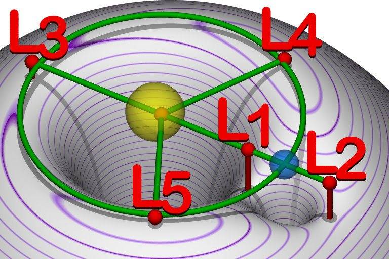

Okay, maybe let's simplify this a little.
Can we rationalize the existence of an L1 'like' saddle point in spacetime curvature between two massive bodies?
Similar to a Roche Lobe, but in spacetime?
The "saddle point" is not in spacetime curvature. It is in the Newtonian potential. That's not the same thing.

I understand, (or think I understand) that the models of Roche Lobes, Lagrange Points, and Hill Spheres are of Newtonian potential, and that the embedment diagrams of spacetime (rubber sheet models) are representing the lengths of paths through spacetime, 2D slices of curved 3D space.
What I enjoy about the Newtonian potential models is how they show the interaction of multiple bodies, which creates the interesting topologies of saddles between objects. I'm not sure I have ever seen a embedment diagram that consists of more than a single, spherical, non rotating body.
Maybe the first question is : Can an embedment diagram be made with more than one massive object?
Follow up : Would the topological features be similar to Newtonian potential models?
PeterDonis said:
No, they're not. They're representing space, not spacetime; and space only in a particular system of coordinates. They are not good tools to use if you want to understand spacetime.
Sorry. I misspoke. You are correct, it's 'space' not 'spacetime'.
(as an aside : Do you think that answer (not mine) that I linked to on stackexchange does a good job of explaining it? I often refer people to it as a way to begin grappling with the rubber sheet analogy. I would love to know if you think it's a sound place to start.)
It does a reasonable job of describing the "rubber sheet" as a visualization tool. It does, IMO, a terrible job of explaining the serious limitations of that visualization tool.
I don't think the rubber sheet analogy is a good place to start at all. The "shape of space" in those particular coordinates is not a good thing to be focusing on.

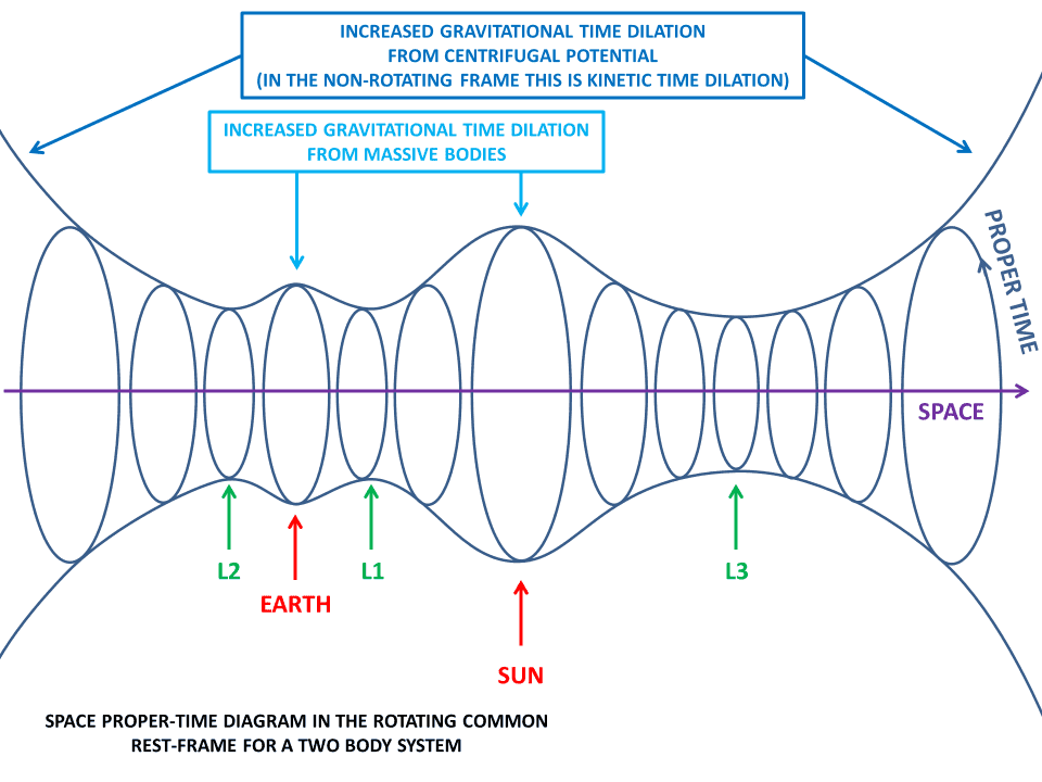

Here is the space-propertime diagram and a geodesic freefall worldline for a single massive body in an non rotating frame:
A.T. said:
The red path is the geodesic world-line of a free falling object, that oscillates through a tunnel through a spherical mass. Note that the geodesic always deviates towards the "more stretched" proper time, or towards greater gravitational time dilation. Gravitational time dilation has an extreme point at the center of the mass (gradient is zero), so there is no gravity there (but the maximal gravitational time dilation).

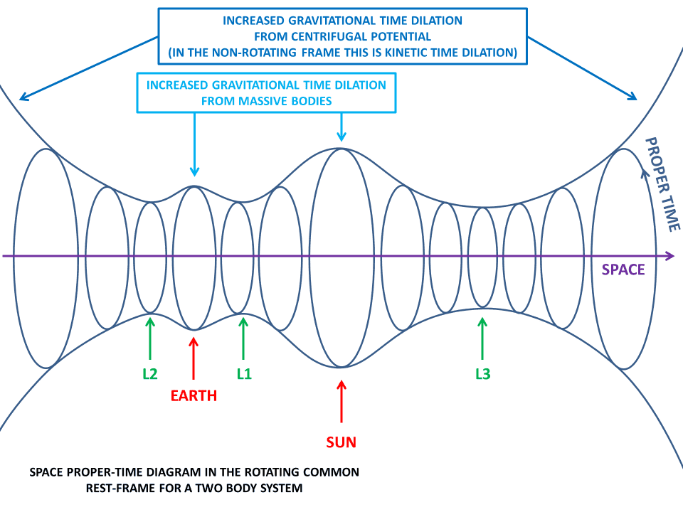

Here is a rough sketch of such a space-propertime diagram for two massive body in the rotating common rest frame (it's supposed to be a surface of revolution around the shown space axis, like above):
Note that since geodesics deviate towards the "fatter parts" (greater time dilation / lower potential), the shown L points are unstable in the radial direction. This is also true based on the Newtonian potential (below). You actually need the Coriolis force to explain why any of them are semi-stable:
https://www.math.arizona.edu/~gabitov/teaching/141/math_485/Final_Report/Lagrange_Final_Report.pdf
Likes D.S.Beyer
This is, quite possibly, the most instructive visual I've seen online in many years.
It wonderfully grounds these 'space proper-time diagrams', which are easily one of the most abstract visuals that come up in discussions like this.
Let me see if I'm reading this correctly.
Disregarding the time dilation from centrifugal potential for a minute... the L points have the fastest clocks, then the earth, then the sun. And, based on the Newtonian potential maps, I would guess that the L4 and L5 points would have even faster clocks than anything else in the system.

Thanks. A intuitive explanation of these diagrams is in the later chapters of this book:
Relativity Visualized - Online reader
Relativity Visualized - PDF download
This is true for all clocks that are at rest relative to the Sun-Earth and the L-points (rotating with them).
Not sure why you want to disregard the centrifugal potential. The Newtonian potential map shown above also includes the centrifugal potential. That why it falls off towards negative infinity, when the distance from the barycenter towards infinity. The pure mass-attraction potential approaches a constant value at infinite distance.
Also keep in mind that both diagrams show a rotating frame. For the space-propertime diagram above the propertime "streching" shows the clock rate of clocks at rest in the rotating frame, along the Sun-Earth-line. In the non-rotating frame, clocks along this rotating line would approach light-speed, if far enough from the rotation center, and thus have infinite kinetic time dilation. In the rotating frame, where these clocks are at rest, this is accounted by the centrifugal potential. That's why the propertime blows up to infinity at both ends (proper time rate goes to zero, potential goes to negative infinity just like in the Newtonian picture)
There's an interesting graphic in a Nasa domain webpage on the Lagrange points, https://map.gsfc.nasa.gov/ContentMedia/lagrange.pdf that graphs the generalized potential with a contour diagram, though it includes the centrifugal potential.
The graph doesn't / can't include the velocity dependent terms in the generalized potential, however.
It's a PDF file, so I can't easily just past the graphic here, it's figure 2. The graphic shows that L4 and L5 are peaks in the effective potential, a little bit "higher" than L3. L1 and L2 are troughs, which are actually saddle points, in the potential.
The reference also has the analytic form of the generalized potential.
If it weren't for the velocity dependent terms in the generalized potential, L4 and L5 would be unstable, like a marble on the top of a hill.
The approach to determine stability, though is more involved than looking at the graphic. From said website
Nasa said:
Usually it is enough to look at the shape of the effective potential and see if the equilibrium points occur at hills, valleys, or saddles. However, this simple criterion fails when we have a velocity dependent potential. Instead, we must perform a linear stability analysis about each Lagrange point. This entails linearising the equations of motion about each equilibrium solution and solving for small departues from equilibrium.
When you add in the velocity-dependent terms, due to the coriolis force, L4 and L5 become stable for high enough mass ratios between the primary and secondary.
The link between time dilation and the potential to Newtonian order is very direct. The square of the time dilation , modulo possible factors of G and c depending on one's unit conventions, is that square of the time dilation is equal to ##|g_{00}|##, as ##d\tau^2 = g_{00} \, dt^2## for a body at rest. For a single central mass, ##|g_{00}| = 1 - 2U = 1 + 2 \Phi##, where U > 0 and ##\Phi < 0##, i.e. U and ##\Phi## are the same quantity with different signs.
If you include the usual factors of G and c, for a central body, ##U(r) = \frac{GM}{c^2 r}##. To Newtonian order, you can simply add the potentials from multiple bodies together.
Finding the approximate effects of GR would involve using a post-Newtonian approximation. But generally, I'd expect these corrections would be negligible.
Keeping the factors of c and G, we can write U(r) in a non-rotating frame with a single central mass as ##\frac{GM}{rc^2}##. And to Newtonian order, we can just add the potentials together from the various bodies.
Oh, something i wanted to add. Knowing the time dilation to Newtonian order, we can use the principle of maximal aging - or it's big brother, the principle of extremal aging- to determine the equations of motion to Newtonian order.
E.F Taylor's book "Exploring Black Holes" goes into this approach in much more detail. A second edition is available on the Author's website for free , nowadays. http://www.eftaylor.com/exploringblackholes/
Much of the introductory work on said principle is in the first chapter.
Likes PeterDonis
And for the Sun-Earth the saddle points L1-3 are actually unstable, despite the velocity dependent terms.
In short, Lagrange points are complicated enough in Newtonian physics. Expecting intuitive visualizations of them based on General Relativity is maybe asking too much.
