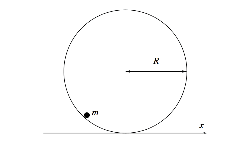

A point mass m is fixed inside a hollow cylinder of radius R, mass M and moment of inertia I = MR^2. The cylinder rolls without slipping
i) express the position (x2, y2) of the point mass in terms of the cylinders centre x. Choose x = 0 to be when the point mass is at the bottom.

You say the cylinder rolls without slipping, but what does it roll upon? Is it on a horizontal surface, a set of rollers, across a hill, or what? The kinematics makes all kinds of difference here.
It is rolling on a flat horizontal surface
