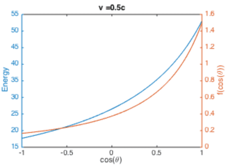

The blue curve is the energy as a function of the angle ##\theta## to the forward direction and the orange curve is the distribution in the cosine of the angle.
I guess what I'm saying is, as long as the momentum of the pion is smaller than the momentum of the lambda (which I can calculate and set as a constraint in my code) it doesn't really matter what the momentum is right ? There's no definite way of predicting it
You never know what the momentum will be. In the rest frame you can know what the magnitude of the momentum will be because everything is symmetric, but you do not know which direction it will go in.
Okay, it makes sense. I think I understand now. Thank you for all the help
