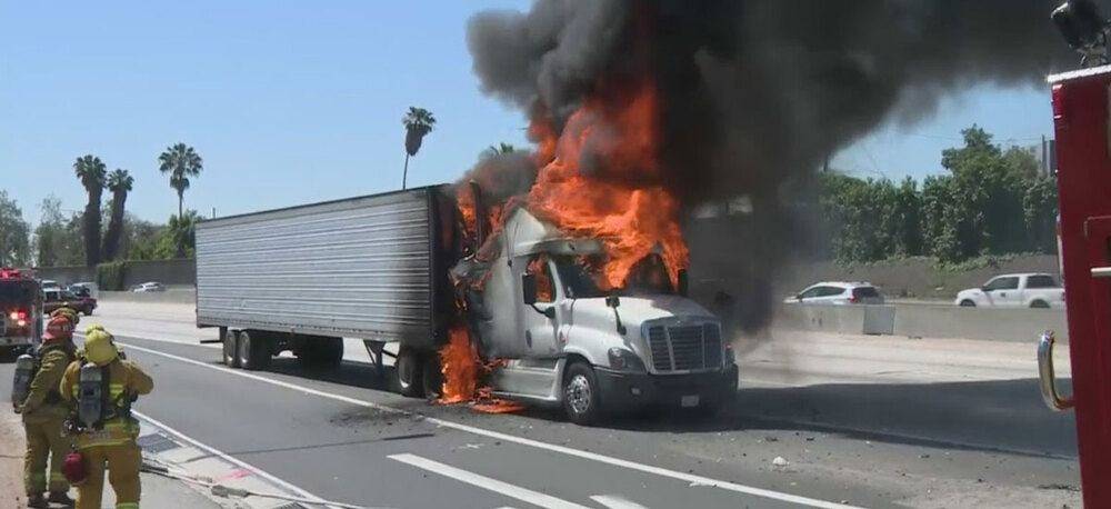

Most likely that picture is from a 'stuck' brake causing overheating of the assembly while the truck is travelling.
A system with braking flaps wouldn't help with such a mechanical failure.
Same thing for trains. If a brake will not release, it overheats and can cause brush fires along untrimmed railway, and train derailment in the end. When a train, or truck needs to stop abruptly, brute force is needed with the available brakes and not a soft slowing down. Other times removing engine power and coasting is employed prior to a full stop or change in speed.

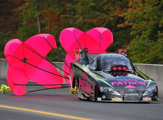

Yeah, that's already a thing:
Can you imagine having a vehicle deploy a parachute in front of you? That would cause a lot of road rage!
