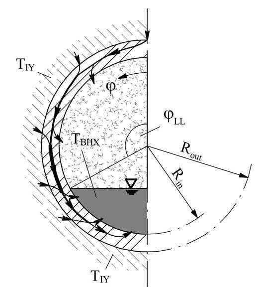

Dear all,
I would need mathematical help to solve for the temperature field in an annular geometry (you find a picture attached below the text):
A copper pipe containing a boiling two-phase flow (in the stratified regime) is immersed in a liquid bath, which temperature ##T_{IY}## is assumed to be constant in the entire cross section. The heat transfer coefficient between the bath and the outer surface of the copper pipe(##h_{out}##) is constant.
The liquid phase and the gas phase of the inside flow are in thermodynamic equilibrium (##T_{liq}=T_{gas}=T_{BHX}##). The heat transfer coefficient between the copper pipe and the gas ##h_{Dry}## is much lower than the heat transfer coefficient between the copper pipe and the liquid ##h_{Wet}##.
The geometry is symmetric with respect to the vertical axis, the liquid level can be expressed as the angle ##\varphi_{LL}##. ##R_{in}## and ##R_{out}## denote the inner and the outer radii of the copper pipe respectively.

Now, there are several boundary conditions for the first derivative in radial direction (##k## denotes the (constant) heat conductivity of the copper):
$$\frac{\partial T}{\partial r}\bigg{|}_{r=R_{out}}=\frac{h_{out}}{k} \left(T_{IY}-T\right)\quad for\;0\leq\varphi\leq
\varphi_{LL}$$
$$\frac{\partial T}{\partial r}\bigg{|}_{r=R_{out}}=\frac{h_{out}}{k} \left(T_{IY}-T\right)\quad for\;\varphi_{LL}\leq\varphi\leq \pi$$
$$\frac{\partial T}{\partial r}\bigg{|}_{r=R_{in}}=\frac{h_{Dry}}{k}\ \left(T-T_{BHX}\right)\quad for\;0\leq\varphi\leq \varphi_{LL} $$
$$\frac{\partial T}{\partial r}\bigg{|}_{r=R_{in}}=\frac{h_{Wet}}{k} \left(T-T_{BHX}\right)\quad for\;\varphi_{LL}\leq\varphi\leq \pi $$
Due to the symmetry, also for the first derivative in tangential direction two boundary conditions can be found:
$$ \frac{\partial T}{\partial \varphi}\bigg{|}_{\varphi=0}=0 $$
$$ \frac{\partial T}{\partial \varphi}\bigg{|}_{\varphi=\pi}=0 $$
Finally, at the position ##\varphi=\varphi_{LL}##, two transitional conditions can be set up:
$$T_{Dry}{\left(\varphi= \varphi_{LL}\right)}=T_{Wet}{\left(\varphi= \varphi_{LL}\right)}$$
$$ \frac{\partial T_{Dry}}{\partial \varphi}\bigg{|}_{\varphi=\varphi_{LL}}=\frac{\partial T_{Wet}}{\partial \varphi}\bigg{|}_{\varphi=\varphi_{LL}}$$

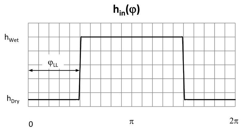

At the inner surface though, the heat transfer coefficient does vary. Therefore I need an expansion to create the right shape. I tried to find one like
$$h_{in}\left(\varphi\right)=h_{Wet}-\frac{\left(h_{Wet}-h_{Dry}\right)}{\pi}\left[\varphi_{LL}+2\sum\limits_{n=1}^{\infty}\frac{sin\left(n\varphi_{LL}\right)}{n}cos\left(n\varphi\right)\right],$$
whose curve you can find in the diagram attached at the end of the post. This correlation I can insert into the BC:
$$T_r\big{|}_{r=R_{in}}=\frac{h_{in}\left(\varphi\right)}{k} \left(T\big{|}_{r=R_{in}}-T_{BHX}\right)$$
$$\sum \left(-nc_nR_{in}^{-\left(n+1\right)}+nd_nR_{in}^{n-1}\right) cos\left(n\varphi\right)=\frac{h_{in}\left(\varphi\right)}{k} \left[\sum \left(c_nR_{out}^{-n}+d_nR_{out}^{n}\right)cos\left(n\varphi\right)-T_{BHX}\right] $$

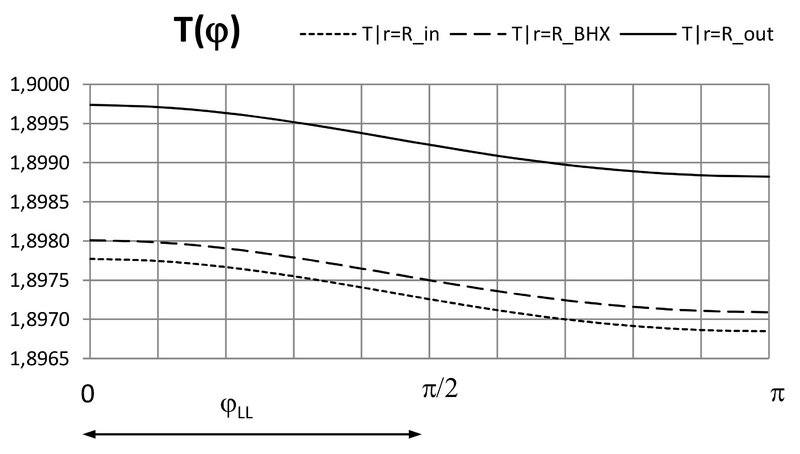

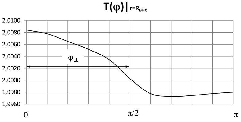

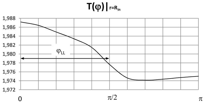

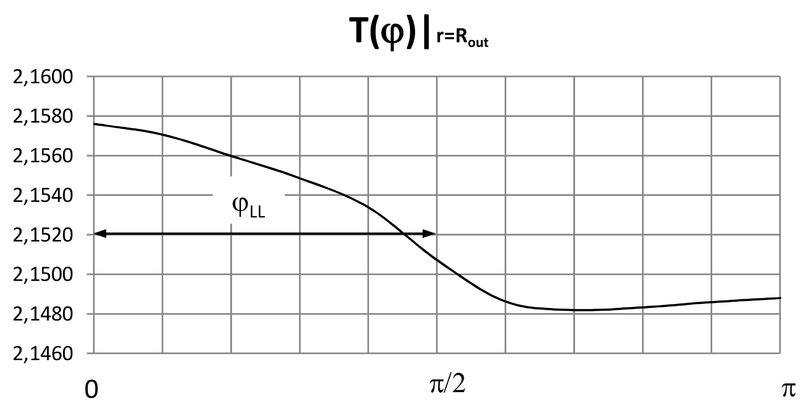

Just an update: I tried to solve the problem with my approach and I've got the first results. After my post you find diagrams with the temperature profiles for ##0\leq\varphi\leq\pi## with ##\varphi_{LL}=\pi/2##. Some comments:
1) The calculations of the sums only was possible for ##-110\leq n\leq 226 ##, since all other values for ##n## yield numbers to high or to low for the programm to process.
2) At the value ##n=0## yields a division by zero. Therefore I didn't take this value into account when calculating the sums.
3) Using the actual parameters of the problem, the resulting curves look strange and the obtained values for the temperatures are wrong (##T_{max}=1.9\;K##). This can be seen in the first three diagrams, which illustrate the temperature profile at three different radii (inner surface ##R_{in}##, half wall thickness ##R_{BHX}## and outer surface ##R_{out}##). By increasing the heat conductivity of the copper by a factor of 100, the resulting profiles become realistic (as illustrated in the last diagram).
Thanks for your help until now. If you have any other hint or correction, I would be grateful.
Typically the ##n = 0## term is very important. However, you cannot treat it along with the others as ##\cos(nx)## for ##n = 0## does not integrate to ##\sin(nx)/n##, it integrates to ##x##.
