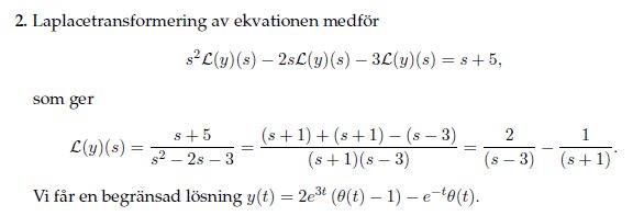

Problem: Find a (limited?) solution to the diff eq.
At the end of the solution, when you transform $$\frac{-1}{s+1} + \frac{2}{s-3}$$
why doesn't it become $$-e^{-t} + 2e^{3t} $$, t>0 ?
That would be correct if the right hand side of the equation were 0. But the delta functions on the right mean that those are correct only for x greater than certain values so the step functions are needed.
What values are those and how are the step functions used?
Do you know what "\delta(x)" and "\delta'(x)" mean?
