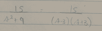

I am given this equation:
and asked to solve using Laplace transforms

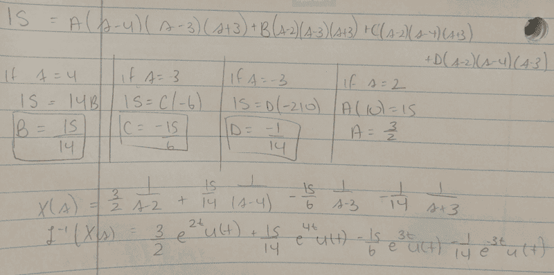

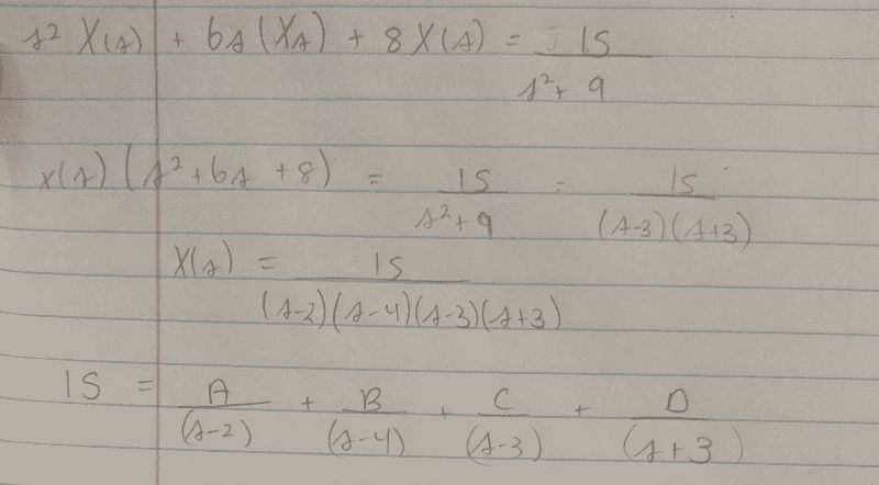

This is what I did:
This seemed logical to me, I used partial fractions and it stayed pretty simple.

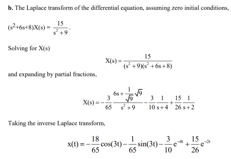

This is what the solutions my prof posted do:
Is my answer equivalent to this, or are their faults in my logic and work ?

One problem I can see with your work is where you write:
##(s^2 + 9) \neq (s - 3)(s + 3)##

Also,
s^2 + 6s + 8 does not factor to (s-2)(s-4). Poles in the rt-hand plane are bad business!
