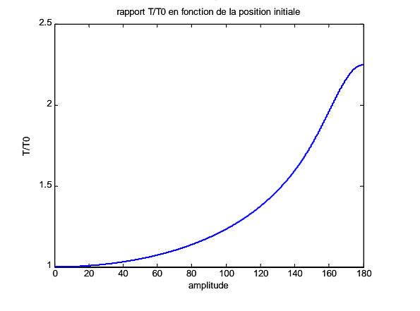

Find the large oscillation period T of pendulum. Suppose that the amplitude is ##\theta_0##
We can write oscillation period T by the sum of a series, know that:
$$\int_0^1 \frac{dt}{\sqrt{(1-t^2)(1-k^2t^2)}}=\frac{\pi}{2} \sum_{n=0}^{∞}(\frac{(2n)!}{2^{2n}(n!)^2})^2$$
Let ##T_0=2\pi\sqrt{\frac{l}g}## which l is the length of pendulum, we have the graph of ratio ##\frac{T}{T_0}## respects to amplitude ##\theta_0##:
The differential equation is:
$$\ddot{\theta}+\frac{g}{l}sin\theta=0$$
I think that using the condition and graph to solve this equation. But how?
Thanks for helping

Thanks, but by a point of the graph I always have: ##(\frac{T}{T_0})_i=\theta_i##
How to get an intergral?
That does not make any sense. The graph is for ##(T/T_0) = f(\theta_0)## where ##f## is given by the curve.
Is that how your most recent coursework has handled things?
Note: you usually need to integrate in order to solve differential equations.
I cannot tell you anything more specific because I don't know what you've just done in your course.

But I don't see how this ratio respectsto ##\theta_0##. As you told, Does ## f(\theta_0)## equals sum?
