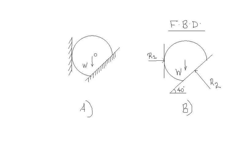

There is a metal sphere which is cut and flattened at on one side and the flat side rests on an inclined surface.
The figure is attatched please refer it.
The weight of the sphere is W = 20*9.81 N .
The sphere will tend to slide on the inclined surface as perceived. But the vetical wall on the left hand side prevents it from doing so and the sphere is in static equilibrium.
The reactions generated at both the supports are R1 ( at vertical left wall) and R2 (at the inclined surface acting Normal to the surface) as shown.
The working out of the Equilibrium Equations the reaction R2 at comes out to be 305.23 N
( We do not discuss about reaction R1 here as it is not of our interest)

However in the example above the Reaction R2 (R2 = 305.23 N) is much more than the ONLY ACTING FORCE i.e. THE WEIGHT of the sphere (W = 20*9.81 = 196.2 N)
I've been wondering from WHERE does this EXTRA FORCE come from or WHAT GENERATES IT if the ONLY ACTING ( AVAILABLE SOURCE ) OF FORCE is THE WEIGHT i.e. ONLY 196.2 N.
What happens and how does the reaction turn out to be greater than the apllied force.

A "reaction force" is an equal and opposite force an object applies back against something applying a force to it. So the force applied at an angle by the wall is not a reaction force to the gravity. This is basically just a leverage issue.

Well, first off, by definition a "reaction force" is equal and opposite of an applied force. So since the force angled off to the side is neither equal nor opposite, it isn't the reaction force.
But what you can do is take the appropriate vector components of the various forces and add them together to obtain the reaction forces. So using trigonometry, if you calculate the vertical and horizontal components of R2, you'll find it contains a horizontal component which opposes R1 and a vertical component that opposes W and all of the forces sum to zero.
This is the essence of the subject "statics" - a sophomore level engineering course.

StartlerBoy: There is a mistake in your current answer for R2. R2 should instead be 256.12 N. Try it again.
Secondly, any (passive) force applied by a support is a reaction force, regardless of the coordinate system you use to express it. R2 is a reaction force. R1 is a reaction force.
Moving on to your main question, the extra force you are asking about comes from the wall. Your surfaces are frictionless. If the wall were not there, the sphere would slide down the inclined surface. The wall stops the sphere from sliding. The reaction force applied by the wall goes through the sphere, and into the inclined surface. This is extra force on the inclined surface.
In summary, if you try to hold up a mass by pushing at an inefficient angle, you must apply more force. Try it. Hold up a mass by pushing straight upward. Now try to hold up the same mass by pushing at an angle, instead of upward.

Again, you're interpreting it wrong. As I already said, r2 is not the reaction force as it is neither equal in magnitude nor opposite in direction. The reaction force is only the vertical component of r2 and it is equal to and opposite of W.
However, the reason r2 can be greater in magnitude than W is, as I also already said: Leverage!

Yes, there is more than one way to analyze the situation, but they all achieve the same answer. If you want to orient your axes along the plane, fine: then you also need to orient the force of gravity along the angled plane. You'll have one component parallel and one component perpendicular and the forces all still sum to zero.
